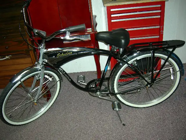

can anyone send me some pictures or links to pictures to help me decide how to mount another 80 cc chinese to this frame.
Im pretty sure the engine wont bolt right uo to this frame

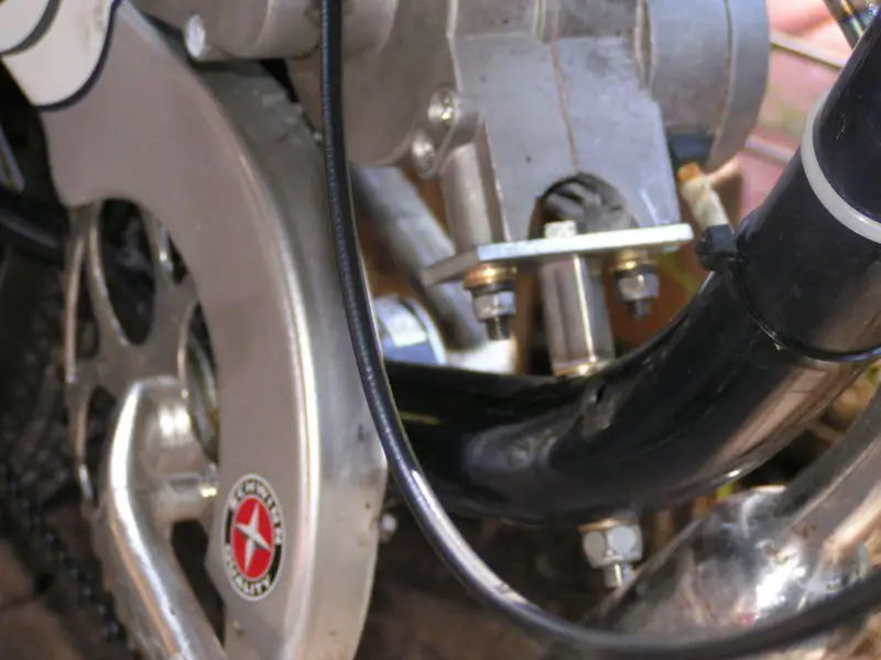

On my Schwinn I drilled a hole through the frame and put a spacer and a flat plate on the spacer. The flat plate bolts to the front engine mount. I don't think I have a picture of it on this computer. Lots of different ways. Cruiser might have some pics of the way he did his on the forum. He'll chime in after while...................

I dont think the tubes are oversize they just dont make the perfect v that you need for the engine to nestle down into.
The seat tube will be ok but the other tube sorta goes straight out then curves up.
I guess I gotta get the engine bolted to the seat tube then go from there.
I just thought some one might have some pictures to give me some Ideas.

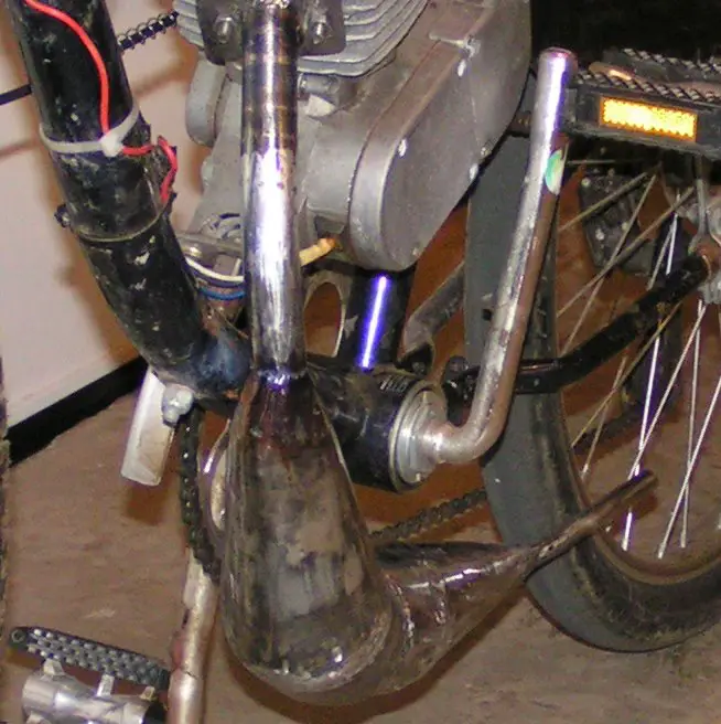

Here's how I did mine. It's not that great of a picture but it's all I have. If this won't work let me know and I'll go out and take a pic of just the front mount. But that may take me a day or two. Hope this helps.............

I dug around on my old laptop puter last night and found this pic. Hope this helps..........................
