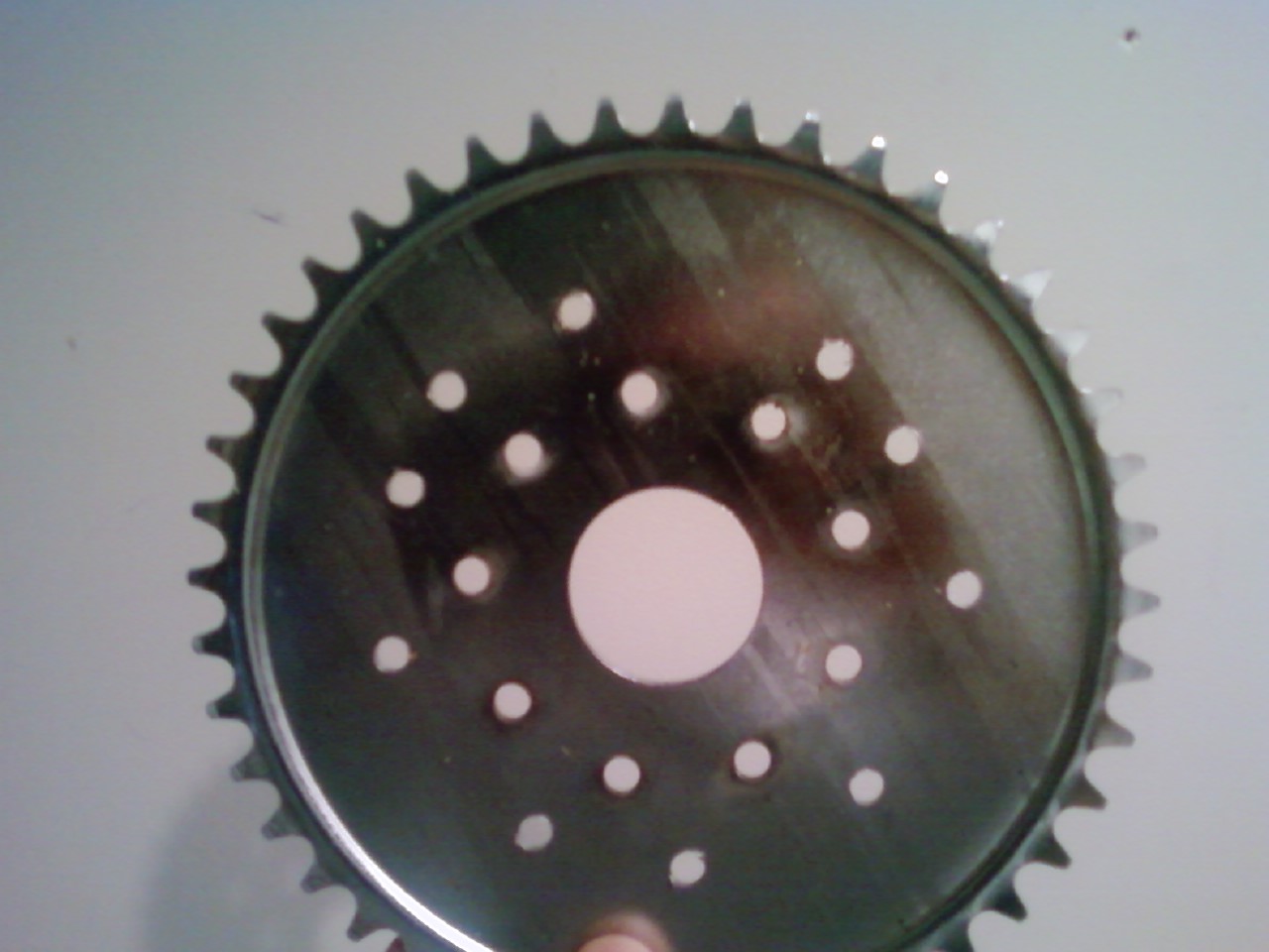

Here's a pic of a "dished" sprocket. It can be flipped around to bring the chain in closer or farther away. Do you think this would be enough to get that chain away from the tire?

you acn also put some washers behind the sprocket before the first part of the rag joint to move the sprocket out a little
