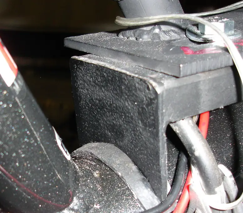

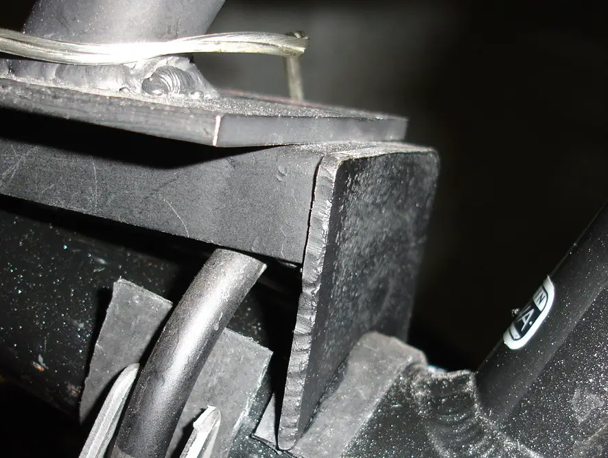

Hello everyone. Just wanted to drop a line on one of my modifications to the Barry mount, that worked nicely for me on the curved frame of the Spoiler compared to the straight frame of the OCC style bike.
The rugged mount definetely made the job alot easier in attaching the engine, the only thing I had to add was a 3" tall support plate to the rear of the mount as seen in the pictures, and zapped a 2 1/2 muffler clamp retainer on the bottom side of the mount plate and then cut out the bottom of the added plate to the shape of the frame itself.
Together with the drilled mount in the front and the fabricated rear,this made for a pretty solid mount on the Spoiler style frame.
Have a great Day. Loubuilt
