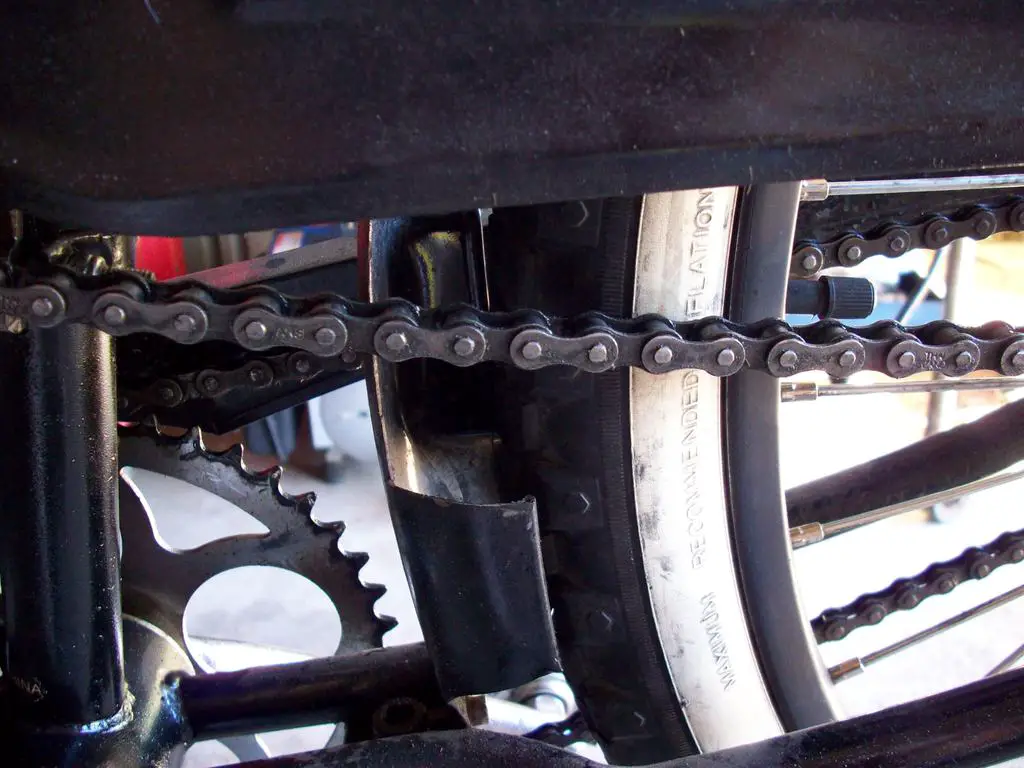

Most just trim the fender to clear the chain

Will your original stock mount hug the frame in front if allowed or is the frame too thick? I mounted mine up front the stock way on my old school cruiser (MOOP2) and moved up my rear mount. It seems to hold well for me and it's aligned straight. And for the fender,someone here suggested a second chain tensioner to pull the chain away from the fender.
I bent mine in a little. It still hits the fender but it doesn't really bother me or the bike it seems.
