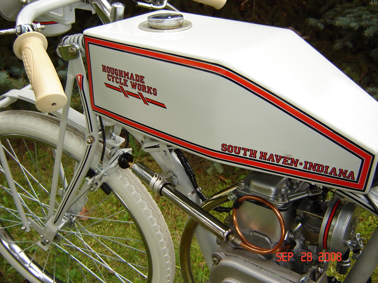

Worked for me.
29/10ths cubic inches of raw power.

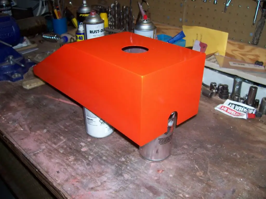

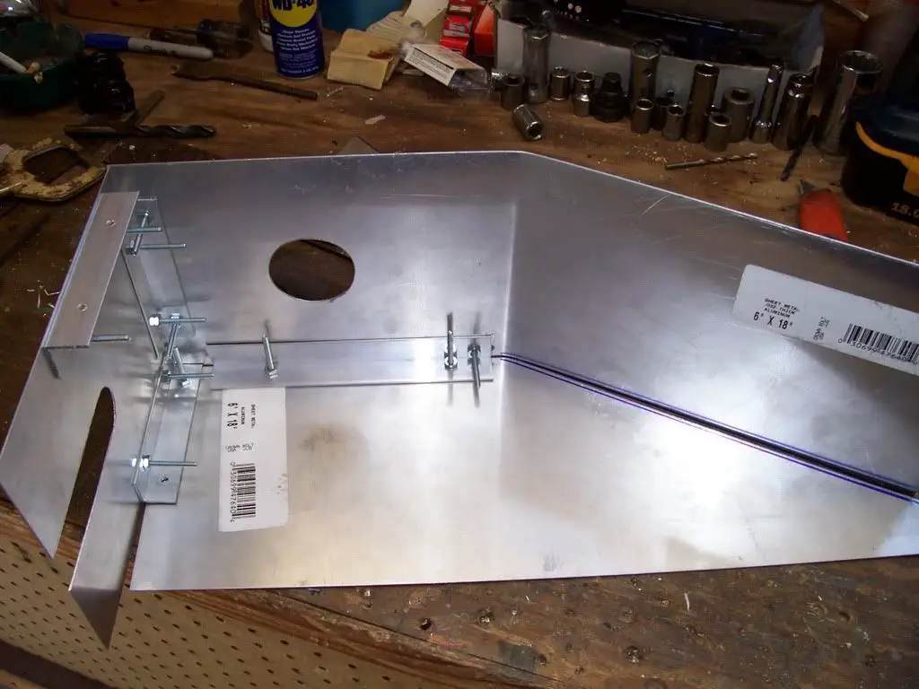

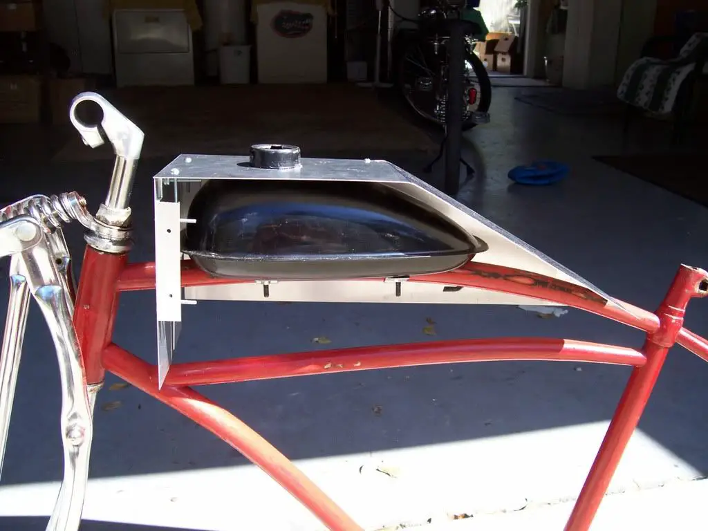

Default Re: Cool Gas Tanks?
Here is one that I have been working on. I used HoughMades concept and made a shell to cover the existing tank. I made it out of aluminum. I used angle aluminum to hold the piesces together with screws while the JB Weld set. It's my first attempt (prototype) and I'm pleased with the results so far.
