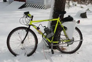

My Mtb bike frame is small and the tank really gets in my way as I ride. (I stand up alot) I've solved this by mounting the teardrop backwards on a rack and I love the way it rides. It looks dumb though and you loose the functionality of the rack. Anyone know where I can get a small rectangular tank that would work? Ideally it would fit the rack and i could bungie stuff on top of it. Thanks for any ideas.

Yep, I've seen that one too, I think it's a Gravely tank, cool but I'm stuck on the rectangle shape. All the lawn stuff I've seen are one gallon and over and I was hoping to stick to around 2 quarts which fits my commute both ways with little to spare- thus no extra weight. If I had a nickel for every mower tank I've looked at I could have one made for me! Right now I'm thinking of making a fiberglass tank custom to the spot using west system epoxy. They say it works if you mix a hardener rich mix. Just hate to waste the time as I feel the right thing has to be out there i just haven't found it. maybe I should just buck up and buy a tig.

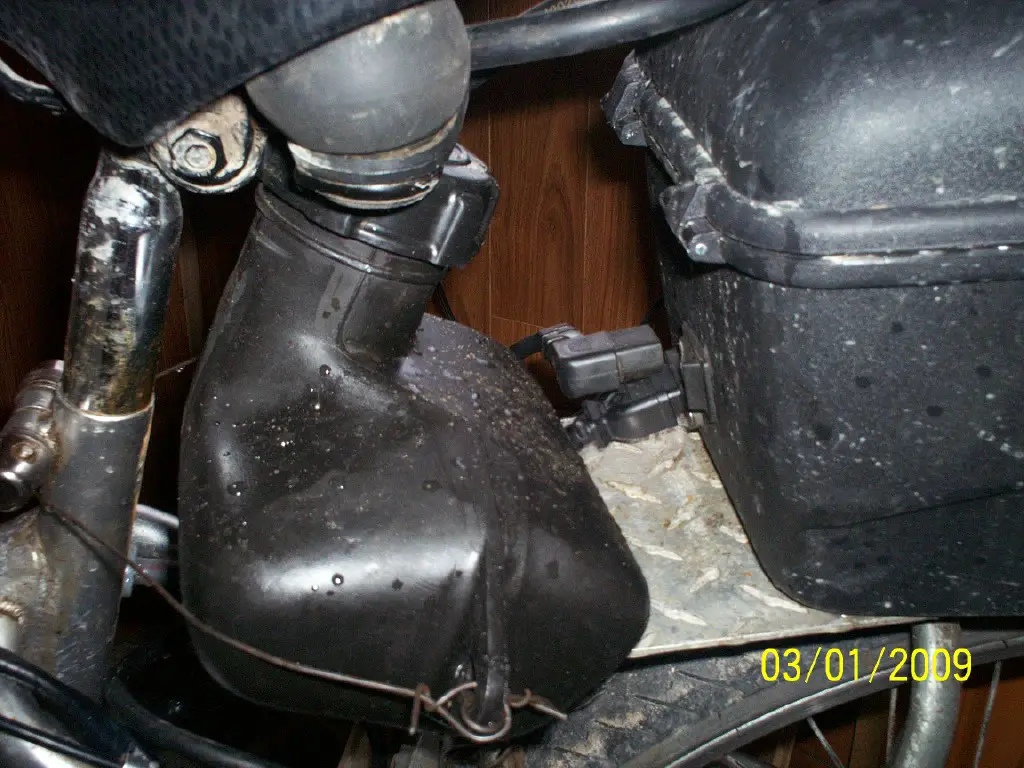

Don't mind the looks of mine, I'm just using it until I get mine built but this holds about a quart and is off a Honda snow blower. It fits under the seat.
