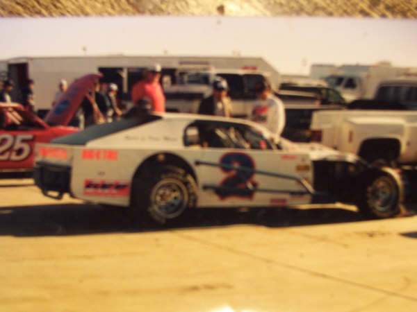

Great Ideal, check out my modified. The entire body is held on with rivets.

now that would be fun to drive. nice, very nice car. i travel around in the midwest and love to watch the sprint cars

I'm drooling again after looking at the car going to rust up my helmet. It's not fair but we don't play fair do we?!
