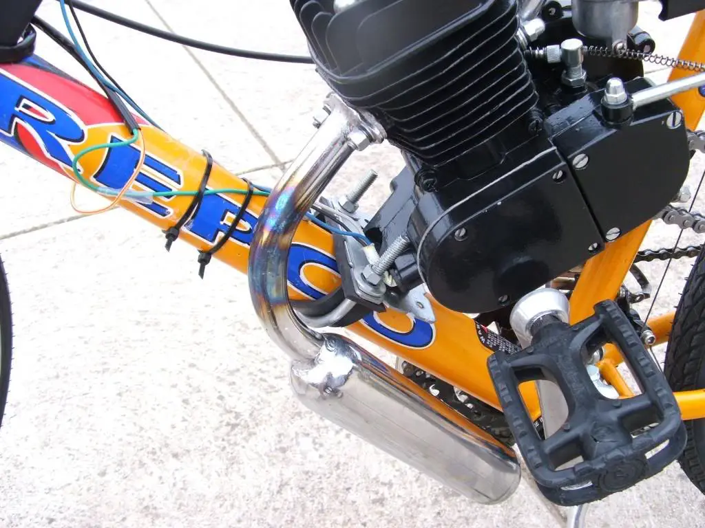

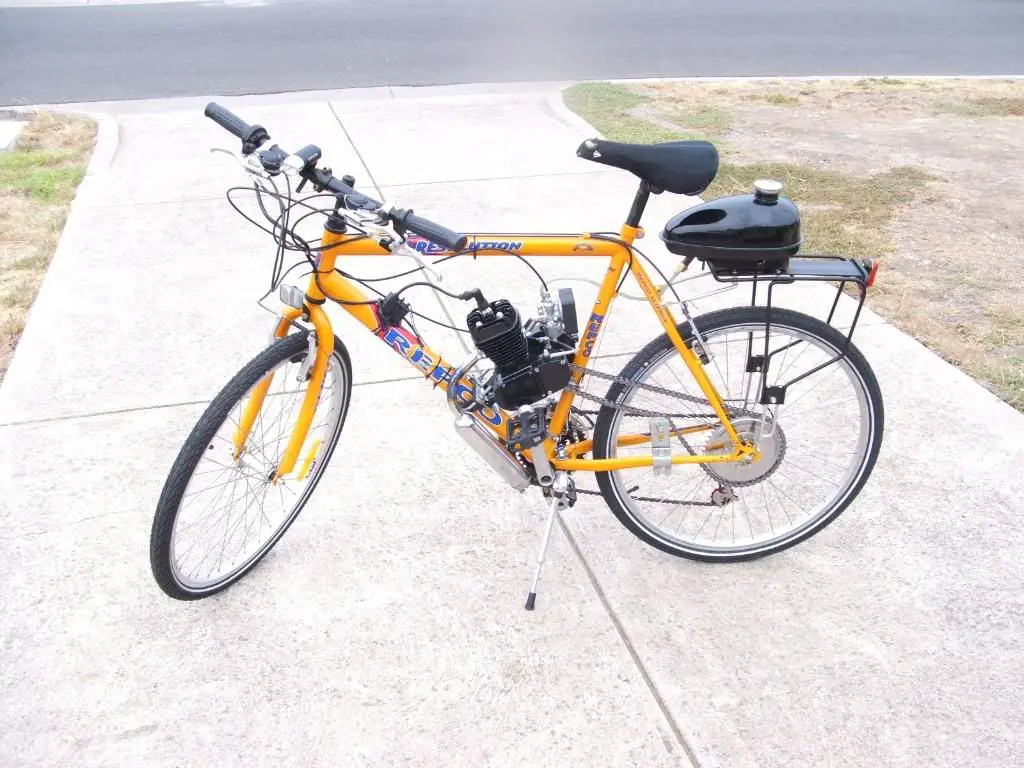

A pic or two:
Oil drips from the clutch cover near the bottom screw.
Some trouble shooting will follow

under the clutch arm cover is where there is going to be a little grease come flying out if its all lubed up good and if you oiled up the chain it will get really nasty until the excess oil if slung off.
When you park the bike your carb will seep oil out of the air filter and that can find its way to the bottom of the bike. The oil seeping out of the filter is just the nature of the beast sort of like a Harley marking its spot. The intake pulses will allow a little bit of the fuel mix to get on the filter and over a short time the gasoline will evaporate off leaving the oil to coalesce in the foam air filter and then it just jumps ship from the filter housing and TADA its on the bike.
When I clean the air filter(wash it in warm soapy water) I do not oil it cause after just a short ride its oiled by the bike gremlins.
If you are getting oil out of the mag cover then that is a main crank seal leaking and that is not good.
Your carb will also leak out of the fuel hose connections the fuel inlet brass nipple with the little red gasket will drive you nuts getting it to stop leaking and it very fragile and will break off easily so be gentle with it. And your float can be set a little high causing a seep along with the gasket that goes between the float chamber and the carb's base. so you see it going to get nasty one way or the other. Brake clean will fix it up pretty quick by cleaning off the poo as they say on dirty jobs. I see you have the carb with the float bowl drain there is one more place for fuel to seep from. Ain't it fun?!

I haven't done the first tank of fuel yet but I note that the leakage rate has really dropped off, so it could have been a combination of clutch arm grease and chain oil as you suggested... just seemed too fluid though. Anyway, there's still a little oily fluid leaking, but it's hardly excessive, so could be from one of the fuel leakages you spoke of. I'll keep an eye out.
I'm convinced now that the noise is clutch/drive related. I had the clutch cover off and noticed when rocking the bike and forward a little, that the metallic noise was quiter (obviously, since no engine power) but clearer. Greasing up the drive gear and clutch wheel made no difference to the noise. (I couldn't believe those gears came unlubed!!! What the?!?!) I've seen a few more "you tube" vids that have exactly the same noise in them, so it's apparently normal... I might end up employing one of the clutch cover ideas I've seen in here.
I also checked the spark plug and it's fine - so it's not a piston smashing into the plug kinda noise.
By the way, I've lubed the chain with transmission fluid - anyone violently reacting to that idea?
