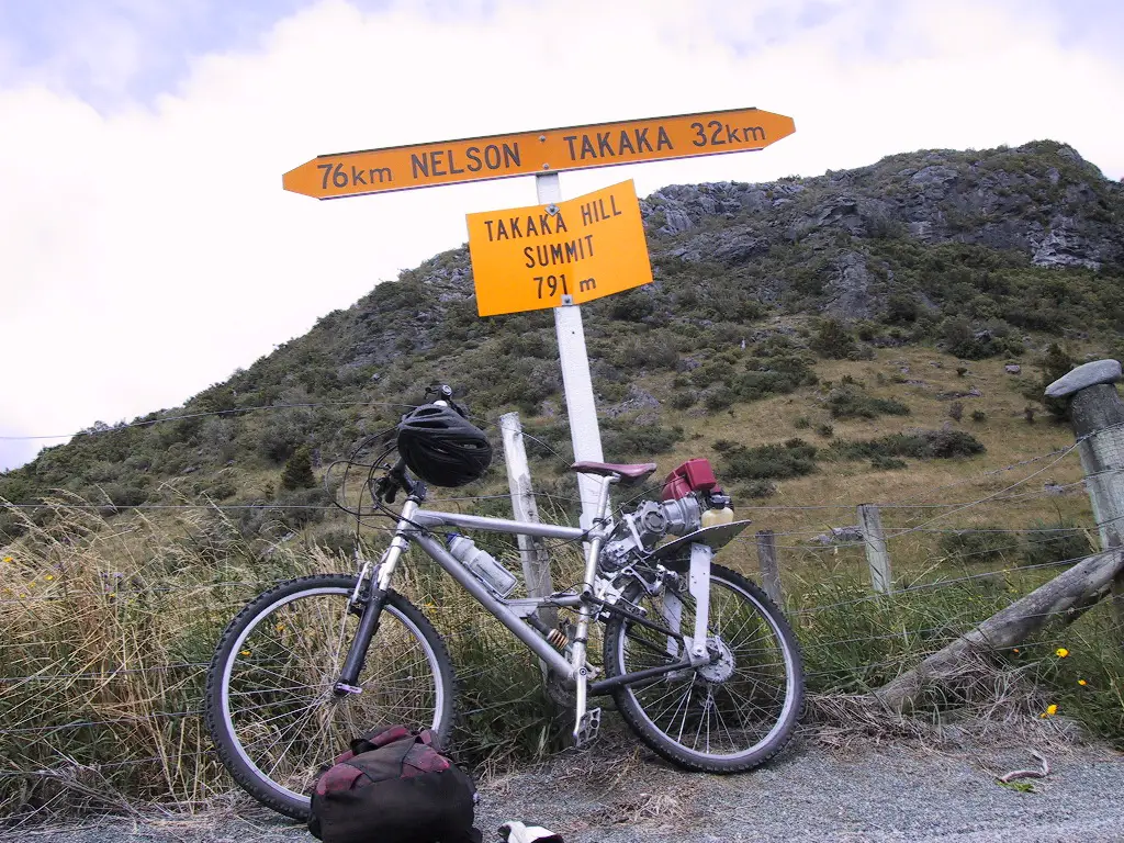

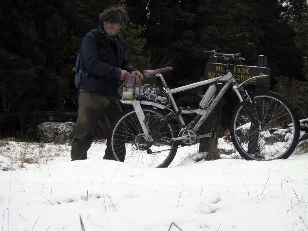

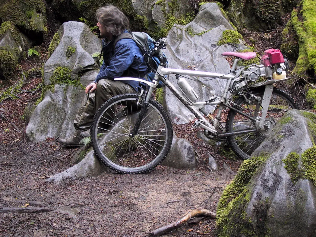

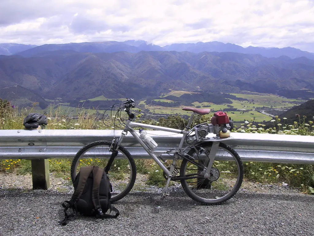

hi from new zealand, just done 10.000km in 12 month with 60.000 meters (60km) accumulated altitude (thats up only)
on a 31ccm honda gx with a reductionbox and a 3 speed sturmer archer copy (shimano) gearboxbox/hub.... on a 15 year old 'gt rst' (power through chain drive, of course, only way to go...see motorcycle history....don't need to reinvent the wheel....) ....yeeeha ( YEEEEEHAAA). done some epic missions offroad, ride weekly from sealevel to 800 meters above sealevel (middle of summer, middle of day=sorts the 'good setup out from the bad ones'), and do weekly a daily trip of 150km, on top of the rest.... (its my only vehicle at the moment....) the 'second hand 3 speed box' lasted 6500km until the first gear gave up (in the middle of a '6 hour singletrack epic'.... up and down....) and replaced it with parts from another hub. good to know that its not the most used gear (third) that goes first,meaning, one can carry on....(e.g. for expedition use....) anyway, about to create 'mark 2' but can't tell you more until its finished. however, having ridden on an old bmw motorbike to the northern and southern most motorcycle rally on earth..... (norway and nz (but not overland from one to the other, (i planned to do that but the embassy of iran (25 years ago when in war with iraq) stole my passport...) and 10.000km in 2 month on my longest trip....ra ra...., my point being that there is no point hanging around the year 1900 when the 'Bicycles with motor dudes' were about to invent the 2 speed and then the 3 speed gearbox. (do you hear of any 'one speed motorcycle' today?) if you want to go somewhere, anywhere, ' you NEED a gearbox and 3 speed is the minimum (8 speed better, rohloff 14 speed' would be awesome (would only use the 8 top gears on the road....) so boys: 'get at it',

WAIT! That IS a hub!
It's used like a jack shaft!
Dude. We need closer shots of that. You must have needed to have added another sprocket to that hub.
(edit)
I just keep seeing more stuff!
Check out your Derailier chain tensioner!
