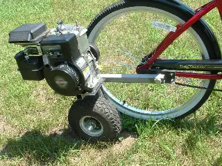

It would be a ton of work trying to use what you have and If I were you, I would look for a Centrifugal Clutch and chain along with a sprocket for the wheel. If you did get it to work the way you want, you would have to come up with a belt drive to your rear wheel but I guess with a welder and lots of time, you could do it.
I am building a push trailer for a Honda motor off a snowblower and just paid under $80 Can. for a ten foot chain and clutch. I'm sure you could get it for a lot less in the States

Oh and a push trailer one of the kinda side-cars with the motor in it?

I guess if you were to do the pulley on "where the peddles are" it would be easier to build the lever needed for the pulley tensioner. There are many push trailers, some are on the side and others are like trailers that follow you. There are even one wheeled trailers that follow and push you.
You will find a few ideas on youtube, including a guy who did what you are talking about
(no peddles), just look around.
YouTube - Motorised bicycle trailer
