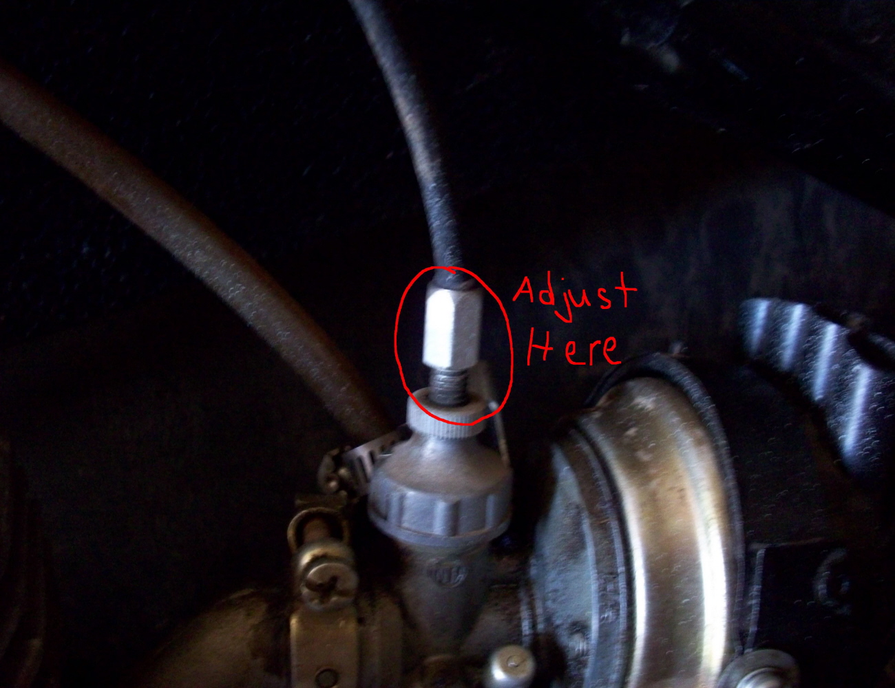

4. Make sure that your throttle cable is nicely lubed and try not to kink the cable. Zip tie onto the bike in too many spots will make it stiff as well. Look at the pic below to see where to adjust the throttle cable.
Name:	carb adjust.JPG
