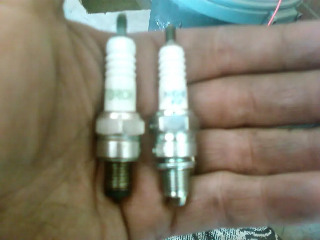

The Torch plug is good but the NGK in my mind is better.
You need to go to a Motorcycle shop to get the right plug. What's cool is that your bike just becomes a conversation starter like you wouldn't believe!
So the exact replacement for the TORCH A5RTC is:
NGK CR5HSA
DENSO U16FSR-U
It's a RESISTOR PLUG!!
The 7 also works but stick with the 5. The engine likes the 5.
NGK CR7HSA
(non resistor...I dunno about this one)
NGK C7HSA
If this does not solve your problem then you may need to look at your wire or boot. Sorry. Never had to replace one so don't know how it comes off. There's also a little air screw on the carb real close to the intake manifold. I play with on my used engine when it did bog a little. I opened it up an 1/8 of a turn and it fixed it.

Here's the NGK CR5HSA next to the stock Torch Plug. Under 2 bucks at the Harley Shop. Sadly for me though that place closed down.
