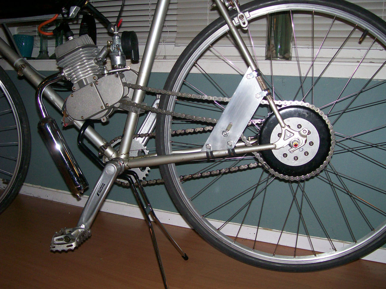

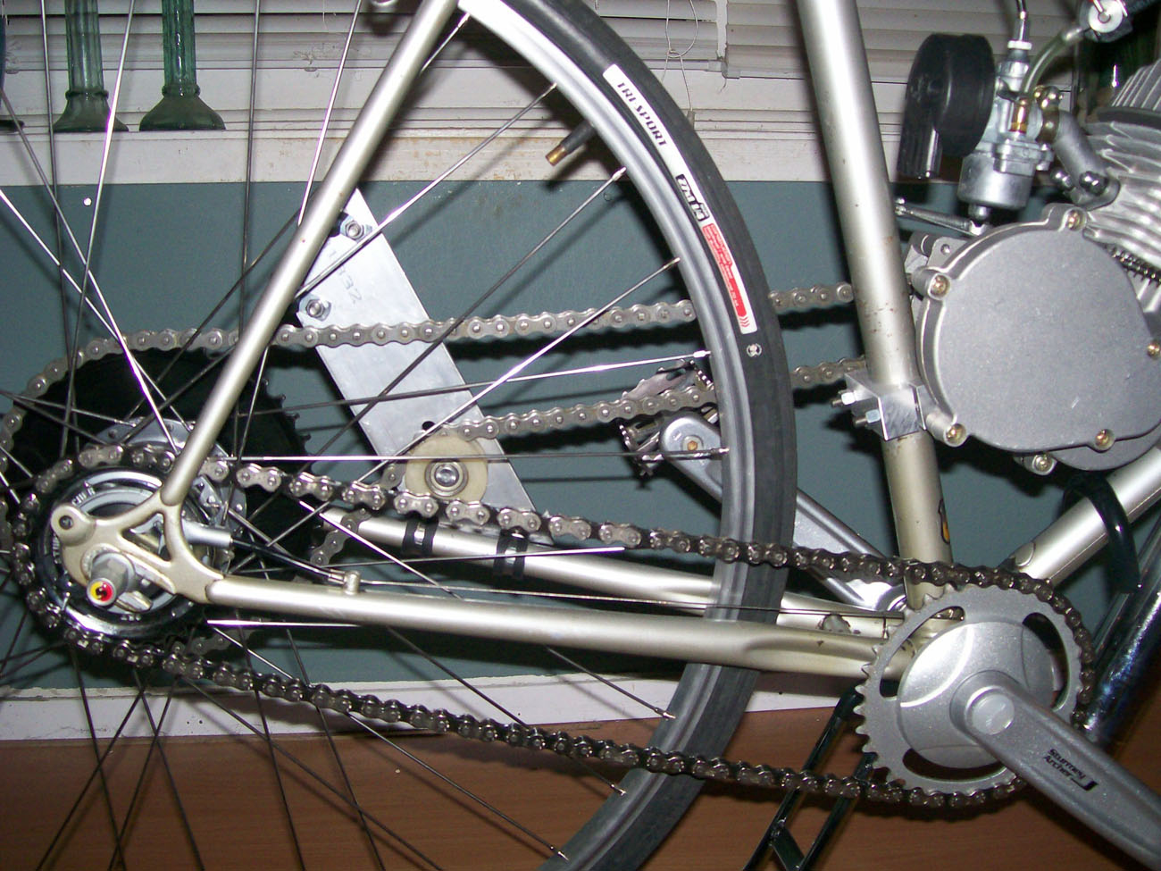

The 8 speed disc mount/drive didn't last me 20 miles! Sturmey Archer warrantied it though. It is possible that I just got a bad one.
