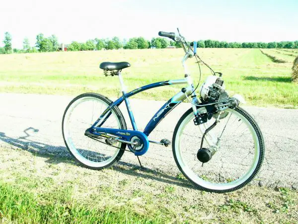

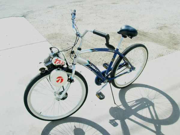

Bike Bug....just don't fall for the Texas guy who wants 25 dollars for an "info packet" before he will sell you parts.
eDJ has one. I had one. They are Tanaka engines, and parts are readily available for them.
The primer bulb gets a little stiff from sitting, but usually softens up once you use it a bit. Will need new gas fo'sho'.
The drive wheels are not as ferocious as they look on tires, but a skate wheel can be used as a replacement, can't remember what size the axle is.
Smoooooth and fairly quiet, will run from a walk to about 22 mph.
Also known as a Sears Free Spirit, and (like mine was) a TAS Spitz.

One more thing....they have a pulse line to the fuel tank, it may have a small crack in it and therefore won't "pump up" to the carb. Look for a loose fit or cracks in that line. I doubt there is anything wrong with the carb if it was re-built in the last 10 years.

No, just replace the pressure line if you find a crack in it.
