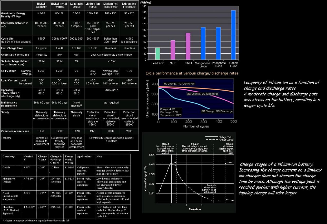

E-bike's are expensive. Yes, SLA's are cheap. But they won't pull that hill without significant sag. The voltage and/or Amps (see Disclaimer) drops over long load pulls. It basically feels like you've used up your charge. A home built electric bike using SLA's will cost you at least $200- 250 not counting bike. PLUS the time and effort. Only to be climbing that big hill and somewhere in the middle saying, "What a POS!" Then what do you do? Sell it to hope to get a little money out of it? Or go lithium and spend at minimum $250, $500 is more like it.
You got a good gasser there. My free advice is to use your money to improve upon it.
E-bike's can lead you on a dark path, my friend. Sure they are powerful, smooth & quiet. Then soon enough you'll be learning stuff you never thought about before. Talking about stuff you never talked about before. Spending money on things you didn't know you needed before. Setting charts & graphs as you desktop wallpaper. Oh God, what has become of me?? The next thing ya know I'll be drinking diet green tea!!
I've got a DAX 80 (69.21564611566 whatever) on the way! Then I'll be fine! Right?
Name:	battery chart combined inv.JPG
