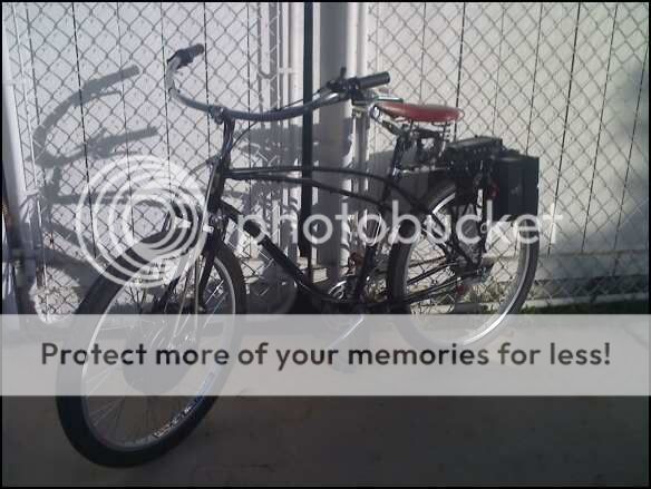

I was on here looking at the 80cc gas powered bikes but I decided to go with electric because those were too loud and I wanted to get off of gasoline.
Well, I got mine built. ONly thing I really need to do now is replace the batteries with better ones. I'm using SLA's and I'm going to go to NiCD.
Here are my tips after sorting through all the bull****. HOpefully this can help someone.
Anyone who tells you that you can get 18 miles out of a 12v12ah SLA is LYING !!! When it comes to e-bikes, you want either NiCD, NiMH, or Lifepo4. Don't waste time with SLA's....just don't. I've got 12v8ah batteries and I can't even get 2 miles range out of them. It could be that they are bad. I don't know but I'm not buying any more SLA's.
For those who like speed like I do, here is what I would do if I were you. I built my bike for $500 excluding bike rack, bike bag, and speedometer. I bought a $400 Forsen hub motor which also came with a 48v 1000w controller. The forsen is good motor in my opinion. I've only had it about 4 days but it looks well built. It's 22 lb motor. It's a good alternative to the 5303 crystalyte (phoenix racer) hub motor. It doesn't go quite as fast. It does go as fast as the Phoenix cruiser motor which is a 5304 and it goes faster than the 5305 crystalyte. (5303/Phoenix Racer is the fastest crystalyte hub motor). It goes 36 mph with 48v but eats up a lot of amps too. My bike goes 27mph so not too far behind and that's without pedaling at all.
I'd also recommend getting a front wheel hub so you can still use all the gears on your 10 speed or 18 speed. It's also easier to install.
Here are two options if you want one those goes about 30 mph or over (without pedaling).
1) phoenix racer kit from electricrider.com for $750 then get some NiCD batteries from ebikes.ca total = about $1100 if you get 48v and speed is 36 mph
2) Forsen hub motor from falconev.com for $475 with 30 amp controller and get NiCD batteries from ebikes.ca total = $800 ...speed = 27 mph
The reason I'd choose NICD batteries is they can handle higher amps so if you go with NICD batteries with the Forsen then decide you want a phoenix racer, you don't need new batteries because the NICD can handle that motor.
Anyway, hope this helps. I'm going to probably buy two 36v 8ah NICD batteries from ebikes.ca to use 72v in series on my motor.
