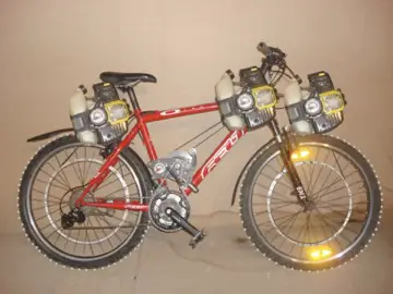

Ask this guy?

Default Re: Are 2,3 or 4 engine motors better than 1???
How on earth does he keep the bike upright...then you got the fumes from the engines in your face and the noise...
Some mufflers are longer than others.. Who knows.. But good point.
I would venture to say 57 still has intellect even if "The Dragon Lady" is a major brain power depleater. If that is the case than you have myth busted the theory exhaust fumes case severe brain damage. I am all excited and want to weld and destroy my eyeballs with flashing arcs of madness.. I should also add my old Bronco with the read window down would draw fumes back through the cab.. A major flaw. I never really had problems on motorcycles and would imagine the rushing air would arrive faster than fumes could especially if the muffler is pointed downward blasting down or modified to do so.

Originally Posted by mabman View Post
Ask this guy?
Attachment 5786
Oh shlitz.. I missed that one! I need a drink.
