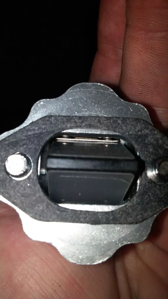

Hey sorry for the delay I don't come on here everyday. I'm selling the reed because I bought it last year and I didn't research it so then I found out I needed a hole in my piston and I didn't want to do that because I use my bike for work and reliability is key for me. I did install it on my bike for about 15 mins and it ran like crap so I took it off.
Its still mint like it was never used I have the gasket for it too. It's a RSE reed 32mm intake studs. I decided to take some photos of me holding it so you can see the actual reed. Its what you see in the pictures. I take paypal I and I will go ahead and ship in on Monday with a tracking number for you if you choose to pay at some point over the weekend. I will pm you with my paypal.me link for payment once I hear back from you with your address and if your still interested. Thanks!
