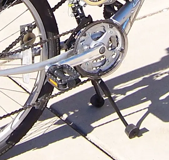

Go to the hardware store and get some rubber stops, drill a hole in them, put them on your center stand. I have the center stand from Spookytooth, and that is what I did. Both tires just touch the ground with the stand down. See attached pic, it makes the stand about an inch longer.
I have a cheaper center stand ($16 on Amazon) on the new bike but it is taller and keeps both wheels off the ground it has little plasitc feet that I suppose if it were to short I could extend with something from Ace.
