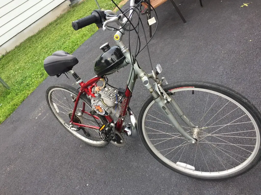

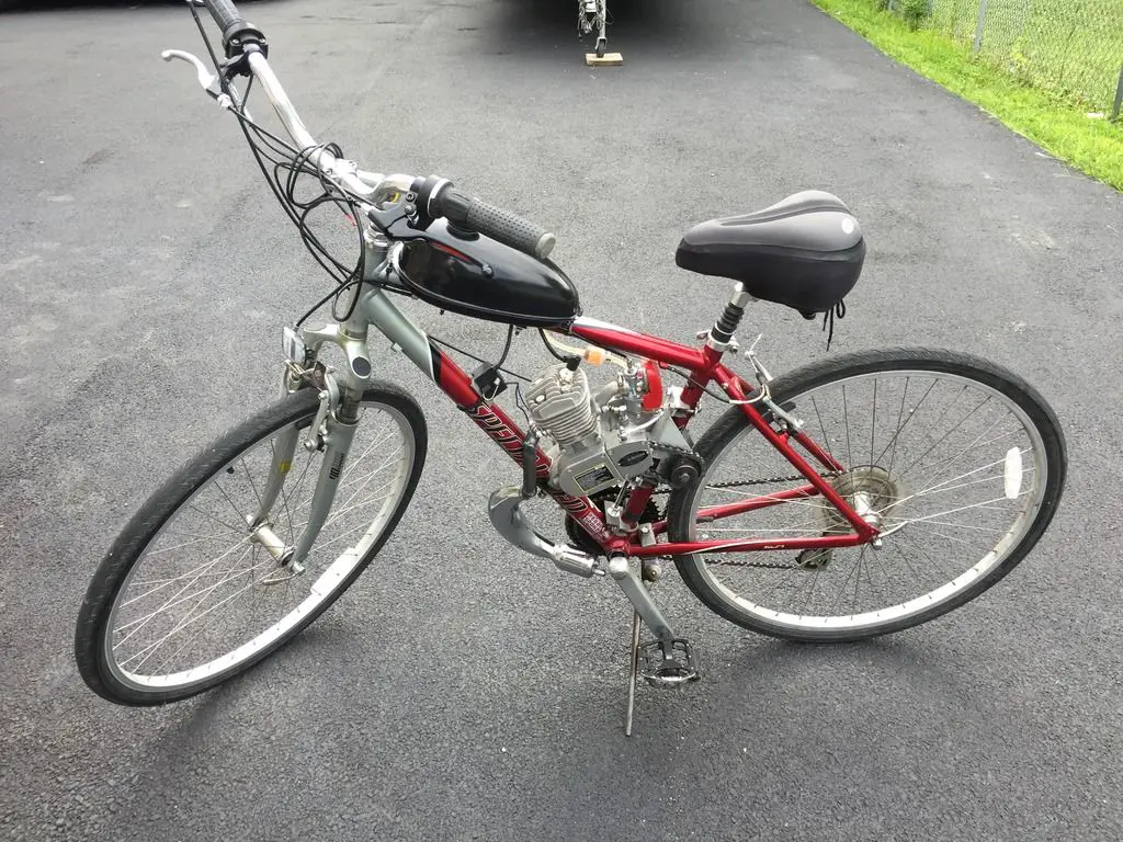

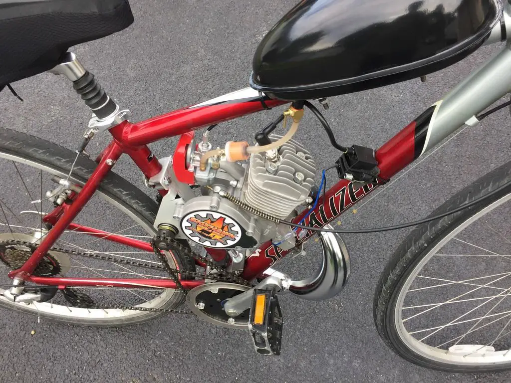

Plenty of room for mounting. A little Dremel work on the front mount, fits perfectly. Back went right on nicely as it was.

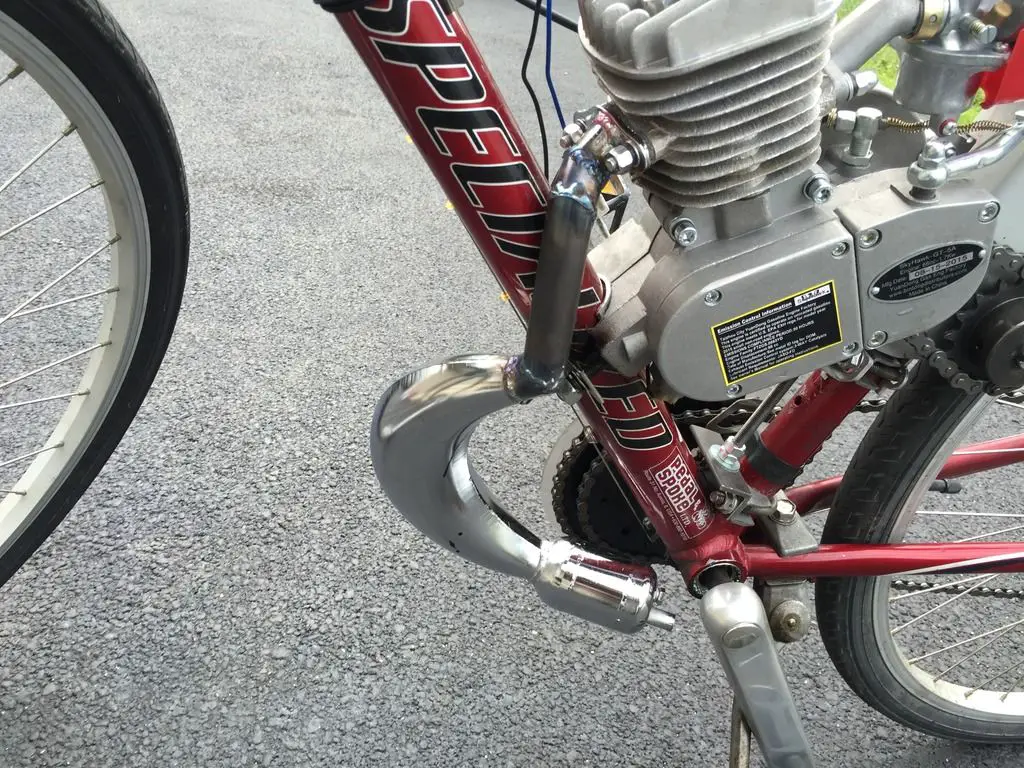

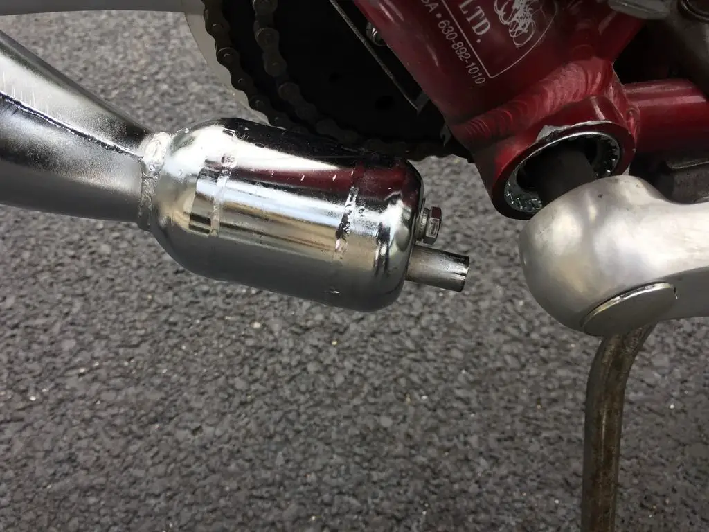

Hi Burrus, I just got done with my Crossroads build yesterday. I was stuck for a bit on the exhaust. I have a stock exhaust that did not fit, I have one of those flexible hose expansions with a muffler on the tip and it would not clear the front tube either. I ended up doing some wild configuration on a banana pipe and although it's not pretty I really like how it operates. The exhaust gets thrown away from the bike and right under the crank but not shooting towards the crank.
I believe that because of the shift kit or the angle of the frame and that big front tube there is just no easy exhaust for this bike. I was thinking of ordering one of those MZ Miami pipes because they look like they have a sharp bend off to the left and could possibly clear but I wanted to use some of what I already had available.
