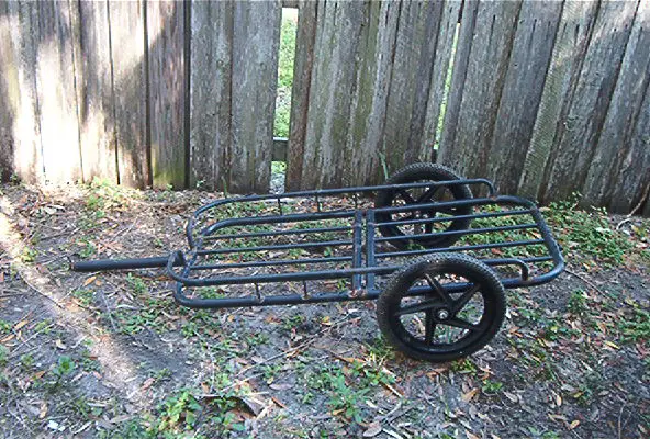

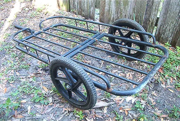

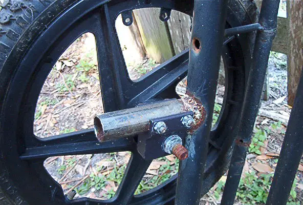

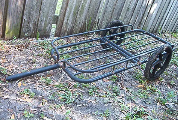

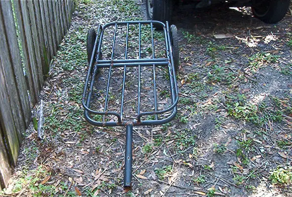

build this tralier out of an old futon chair and part of an old bed frame and the wheel mounts came off an old wheelchair
weak spot is the tounge cuz its only welded on but im goin to fix that
this was made for a 4 wheel bike so youd need a dif tounge for a bicycle
the total length is about 5'8"...the bed holds 3 storage containers and they can be stacked 2 high for a total of 6 containers
i use this for takin recycling to the dump sometimes behind the 4 wheeler
