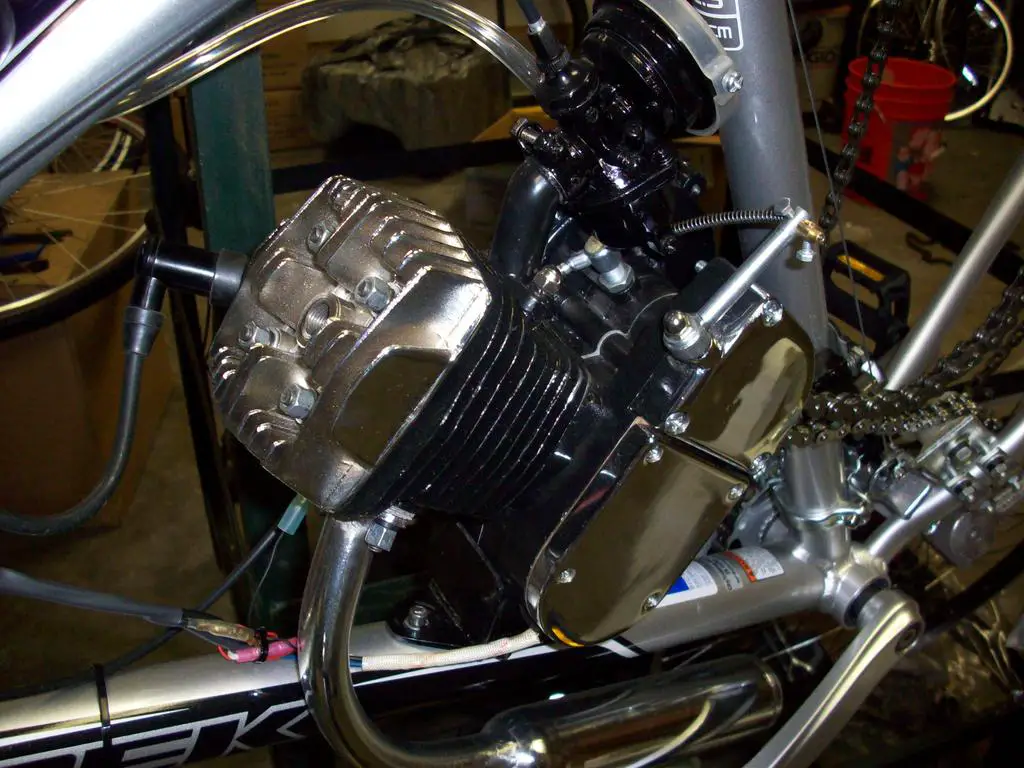

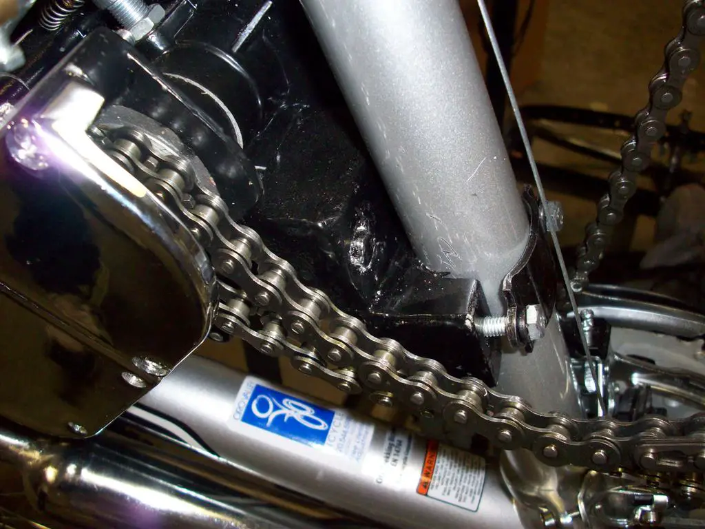

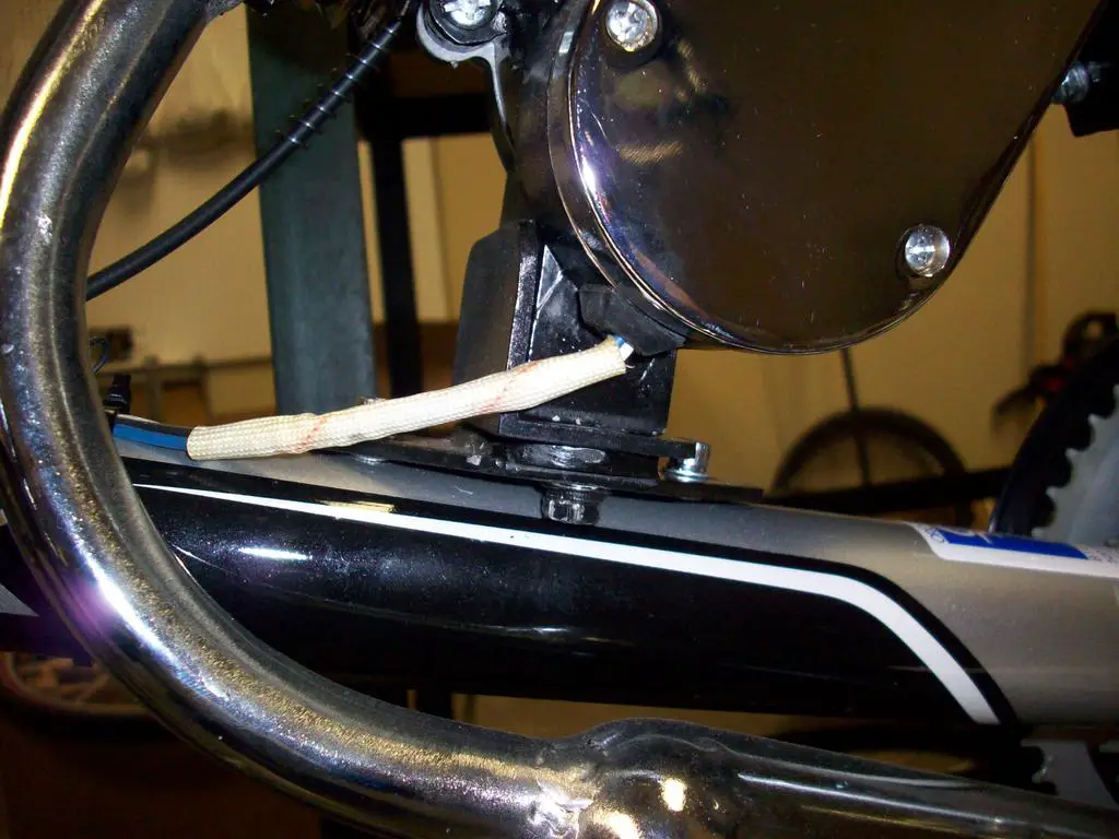

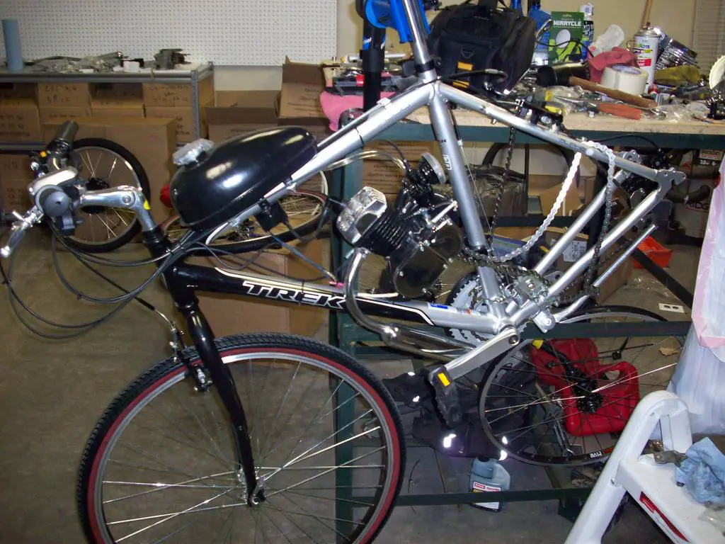

Here is a aluminum frame bike that USABikeMotor.com is building
They have a front motor mount that bolts to the existing bolt holes for the water bottle cage.
