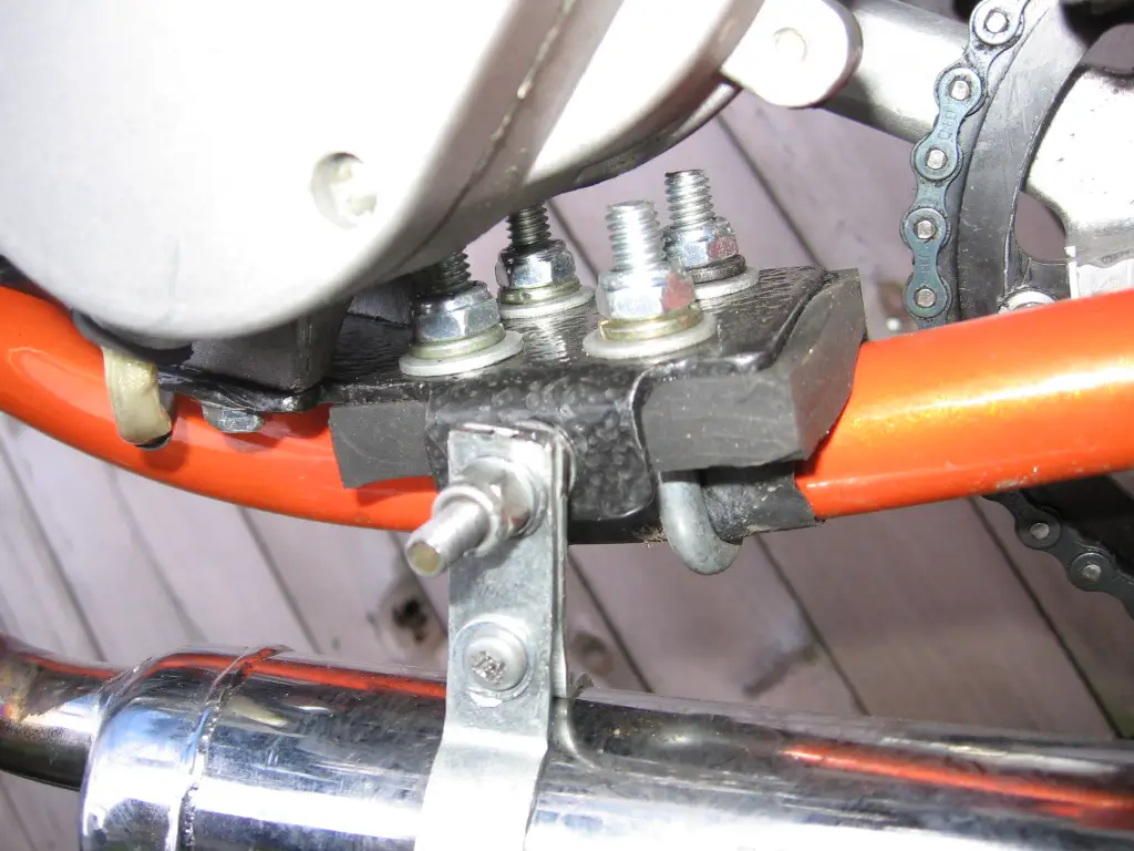

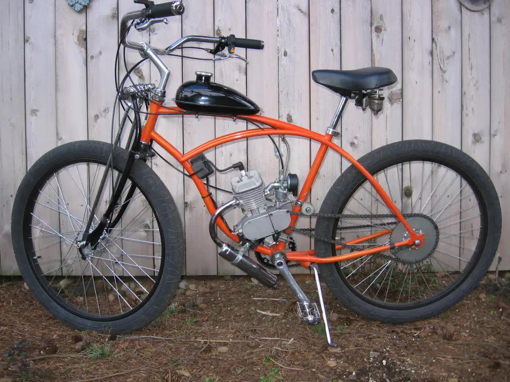

Another option is to build your motormounts offset. I built mine 1 cm off to fit hookworms. I also had to dish the rear wheel , and spread the reart chainstays, and use a long rear axle. Might need wider crank arms or an adapter. But it is doable.
