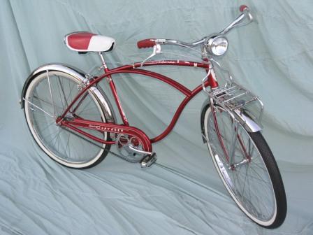

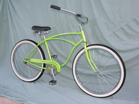

I am new to the forum and just ran into a problem with the first step of my first build!!! Hope I am in the right forum and am not repeating a tread. I have a 1957 Schwinn Corvette 2 bar Cantilevered Beach Cruiser. I purchased aftermarket "China" Chrome wheels with 26 x 2.125 WW. When I installed the sprocket from my 80cc Raw Kit on the rear wheel , the hub "cog" (if that is what it's called) does not stick out far enough past the sprocket to reattach the coaster brake arm. I know the arm will hit the mounting bolts of the sprocket but I know how to bend it to clear...except I can't even slip the arm on on the axle. I called the kit dealer...he said buy a hand brake!! Suggestions? Any other obvious problem I will encounter trying to motorize this bike?
Thanks for any help
Jim
Indian Wells Ca
P.S. Since I'm new I have added a picture of my bike I want to motorize...and for fun another 1957 Schwinn Corvette I purchased when I was 12 years old and just finished restoring.
