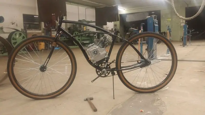

So it was a toss up between the 79 and the 212 and I figured they're so close in physical size that I'd go with more power. Don't need to use it but its there if its needed. I want my bike to do 50MPH without hesitation and have good acceleration off the line but I don't plan on taking it over 40 =-)
This is going to be a slow build and I'm hoping to get it done for the summer and my funding is coming from donating plasma which is $200 a month
I have a frame but its a tad bit small and I can't afford a new frame so I will lengthen it where I need it to fit this engine with a little room to remove the valve cover (good idea came from scotto's build)
I bought the engine and removed the governor and oil sensor. Need to order a billet flywheel and piston connecting rod
Is it reccomended to upgrade the cam and springs as well? Any advice is greatly appreciated
Still need:
Front suspension fork
Front hydrolic moped disc brake set up
Either rear vbrakes or disc on a jackshaft or both?!
Transmission system of some sort
Jackshaft
11 guage spokes
HD rear hub
Front disc hub
Wide pedal crank set up
Engine mounting set up
Throttle set up
22mm mikuni carb and filter
Fuel tank
Tach/hour meter
First i'm building the engine and working the frame to fit it. Then I will work on the wheels followed by a new fork and hook up the brakes. Last will be the transmission system / jackshaft. I'm ordering parts mostly in that order. And maybe the small extras when I get extra money
I'm all about safe stopping and a strong frame!
So I'm super stupid when it comes to numbers and gearing and all that good stuff. I just don't get it... I try but it doesn't click
So my biggest problem (besides engine internals) is a transmission set up. I can build my mounting plate to the motor and a jackshaft but I don't understand the gearing for what I want to do. Like a drive sprocket to centrifugal clutch to sprocket to jackshaft sprocket to rear sprocket....
Or I could buy the gasbike trans that they sell for this engine and adapt that to my jackshaft to the rear sprocket but I still don't know the right size gears to use on my jackshaft and rear wheel sprocket
I wanted a qmatic tranny but not 100% sure it will fit the 3/4" drive shaft. And then again there's the jackshaft to rear gearing I need help with
I like the small size of the qmatic to keep the entire set up thinner than wider
Again. I'm looking for good acceleration with little or no pedaling and a top speed of 50 so I can cruise nice at 35-40
I need help! Please and thank you! I will post pics along the way as I go but its gonna be a long ride before the first ride!
I love critisism and feedback and ideas of all kind!
Thanks all!
