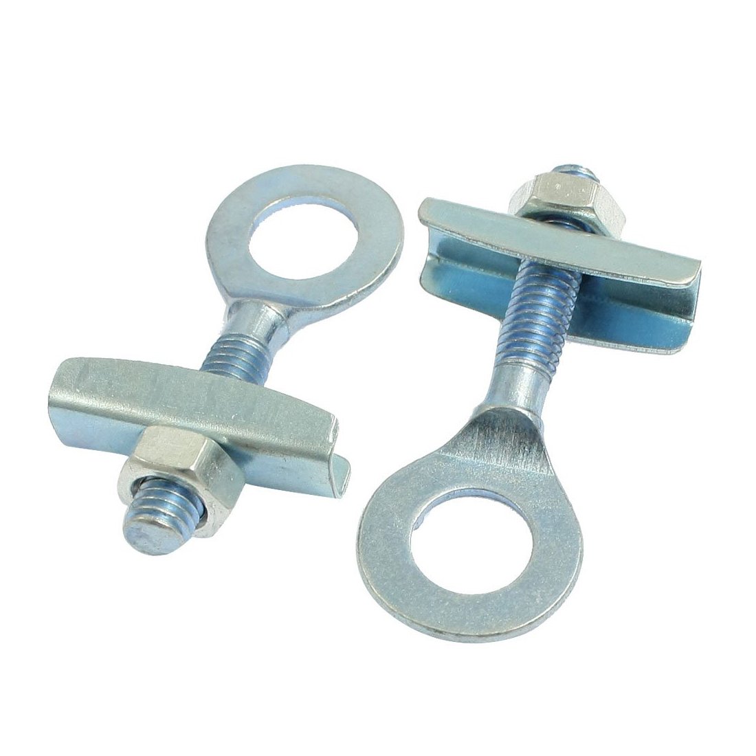

One thing you will notice soon enough is that Nexus don't want to stay in place on the right hand side, the torque pulls the right side forwards.
The fix is to make sure your left side coaster brake arm is firmly attached so the left side won't more, then put an 'axle tug' on the right side to keep the wheel from moving forward.
It's just a washer with a threaded shaft and something to hold the back of the frame.
Most are designed for an open back horizontal drop-out.
https://www.google.com/search?q=bicyle+axle+tugs&ie=utf-8&oe=utf-8#q=bicycle+axle+tugs
Unfortunately most coaster brake bike frames are 'fish hook' open front dropouts.
I use these for my 3-speed shifters, 2 for $2 and you only need one for the right.
The Nexus hubs axle nut doesn't have a lot of play room, but that thin washer is just right.
Then it's just a matter of getting an anchor point behind the dropout.
I have used all kinds of little L shaped pieces of metal with a hole for the bolt to come through, and work just fine like this.
But usually not and you have to get creative.
Anyway... that's how you keep that Nexus from wanting to move forward.
Ohhh, one more note, do NOT torque that set screw to tight!
All it needs to do is keep the actuator attached to the right lug nut.
Tightening it too much with strip out that soft aluminum housing.
