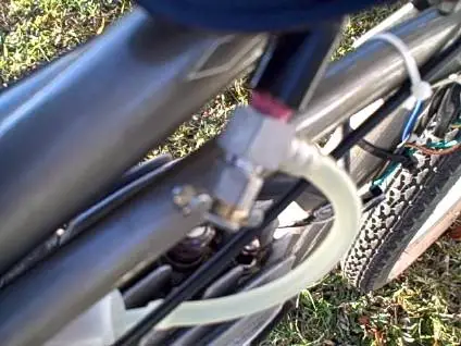

Very Slow Fuel Flow
I have always noticed that when I open the fuel valve I don't get a stream of fuel, just a drip to the filter. Today when I was riding it ran out of fuel and died. There was plenty in the tank, so I waited (about 15 minutes) for it to drip enough to the filter and rode home. I pulled the valve off to see if the little internal screen was plugged. It was perfectly clean. I went ahead and removed it since I am running a good inline filter thinking that would solve the problem. Put the gas back in the tank, opened the valve and just get a slow drip to the filter. Whats up with that? Do you guys get a steady flow to the filter. I'm thinking of getting a better valve, but not sure it thats the problem. Oh this is with the standard tank with the vented cap.

Are you sure your cap is venting? How does it flow with the cap off? If it still will not flow with the cap off I'd say go ahead and replace it. SBP has a cool one...
Sick Bike Parts Products
Mine when I first turn it on I barley see any fuel flow out, sometimes none at all. But once I fire the motor up you can see it flow, So far I have had no problems.

It doesn't make any difference with the cap off. I think I will go ahead and order one of those from SBP. Those look pretty sweet. I need a couple other small parts anyway.

you might need to find the sweet spot on the fuel valve some need to be tweaked or opened just so to get a good fuel flow.

Most fuel valves flow with the lever pointing up at the tank & down at the carb; but some valves only flow fuel in one of these positions! Check it??

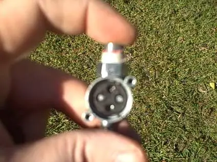

i disassembled my stock petcock (i love that word) when having the same issues. I found that the rubber gasket inside was poorly molded and particles were actually stuck in the inner openings of the valve. the way the stock valve flows is very odd. I posted some pics of the internals. I replaced my valve from the local lawn mower shop for 4 bucks but i had to retap the threads..
