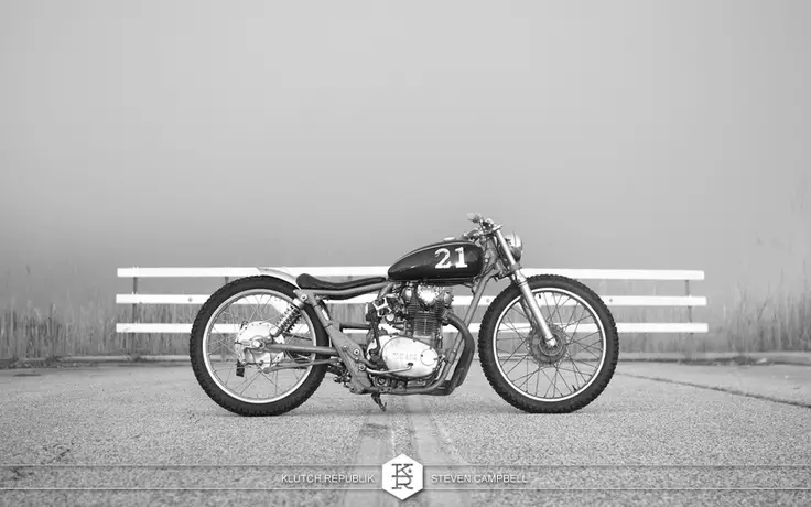

That's where I'm heading O1..im saving for a yami 650 or similar. That pic is the way ill go...just have put ole man bars on it... hoping your bike gets found.
