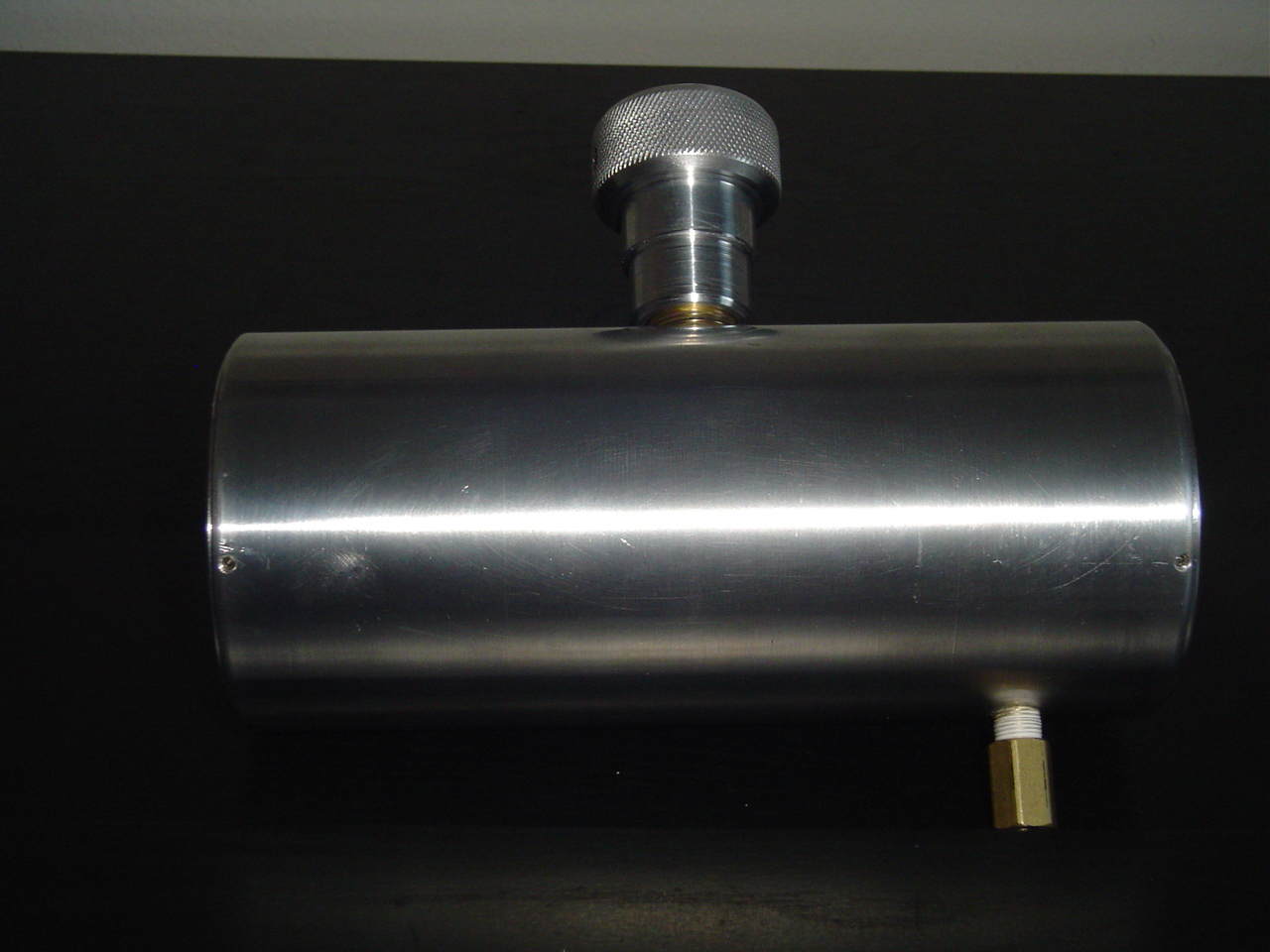

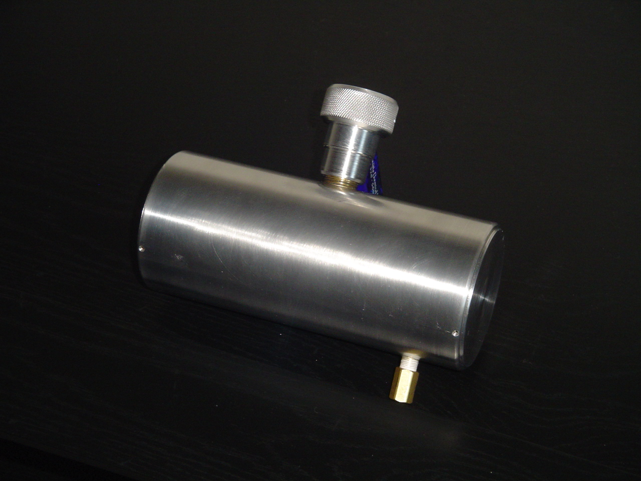

I have been watching the local craigslist for another bike for my next build. I have decided to build some parts while I search for the frame I want. Here is the fuel tank I made that I am going to mount under the seat. It holds a little over a quart. Its made from a piece of aluminum tubing with o-ring fitted end caps. Just something different. (It's been a long winter.)

Yes, I got a bunch of scrap aluminum, and aluminum tubing from the last place I worked when it closed. It would probably be less work to just Tig. the end caps, instead of cutting the o-ring grooves and set screwing the caps, but I would have to run them over to a friend of mine, so I just do the extra work. I have plenty of time.

Love it. Are you still going to run the kit tank and use this as auxiliary fuel. Just 'T' into the fuel line?
That's cool. Think I'll build one. Where I work we have some thin wall stainless pipe laying around. Some 3" diameter stuff that would be just about right. Thanks for the idea.

No Tom, I am just going to tuck it under the back of the seat. It wont be very noticable since it is only about the same width as the seat. It is 3" I.D. tubing and a quart of gas is enough for me, I don't take any real long rides. The next bike I am planning on building wouldn't look very good with the stock tank on the top frame tube so that is where it is going.
