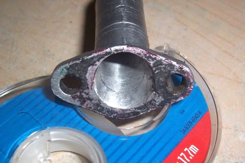

My 50 mile ride turned into a Epic Fail today. Half way there I was kicked in the nuts hard....bad part was I left the spare at home...
How many of you has this happened to? Looks like the result of thinning the metal out, heat and high vibration. I need a bracket to hold the intake/carb stable. Im gonna figure out how I can rig something to brace them off and keep the vibrations down. It should also control the foaming of the fuel in the float bowl some.

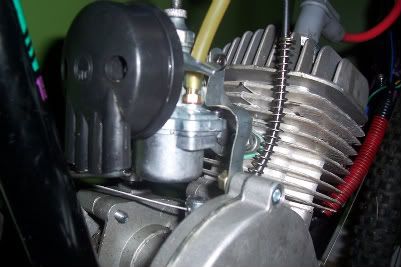

Ive been looking for one but cant find a supplier....Ive got my spare on and even made a weak attempt at bracing the carb a little but i dont think its gonna help.
Maybe itll help, but probally wont. Im gonna keep trying different things though. Im thinking change the bend where i can drill a hole and run the float bowl bolt through it to.
A stiffer bracket may help. Is your spare ground on as well?

No my spare is completely normal aluminum cast. I pieced the broken one back together so you guys can see the extent of my porting. The only thing i can think of is a crack began at the top and worked its way around the seam...

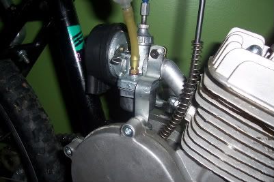

The bracket does seem to be working as far as keeping vibrations of the carb/intake down. While testing the bike out today. I did a slight port on my spare intake, couldnt resist. While testing though i noticed the fuel filter didnt bubble up from vibrating and fuel flow stayed consistent in the filter. Bike ran alot better to, could i have stopped severe vibrations in the float bowl as well? The piece of metal I used came with the kit and I couldnt find a use for until now. I guess ill keep it that way.
Looks like the crack may have started at the flange.
Yep im thinking around the top, When I caught it was cracked, it was hanging on one side. Id say it started on one side and worked its way around.
