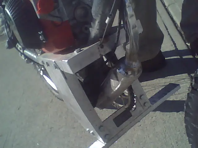

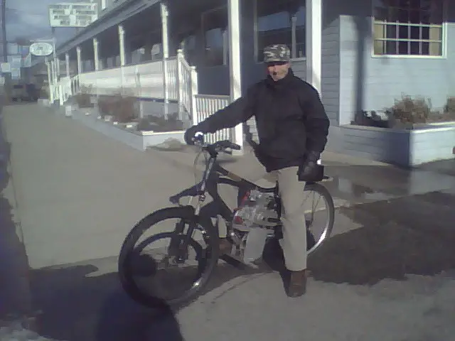

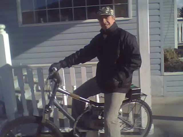

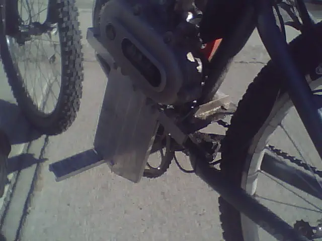

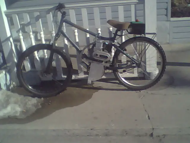

Still no response on how to make a new post--here are pictures of my friends new build-- he made all of the gearbox himself--real nice to ride!!
7 speed bike like a Ferrari--Italian made in Canada!!
