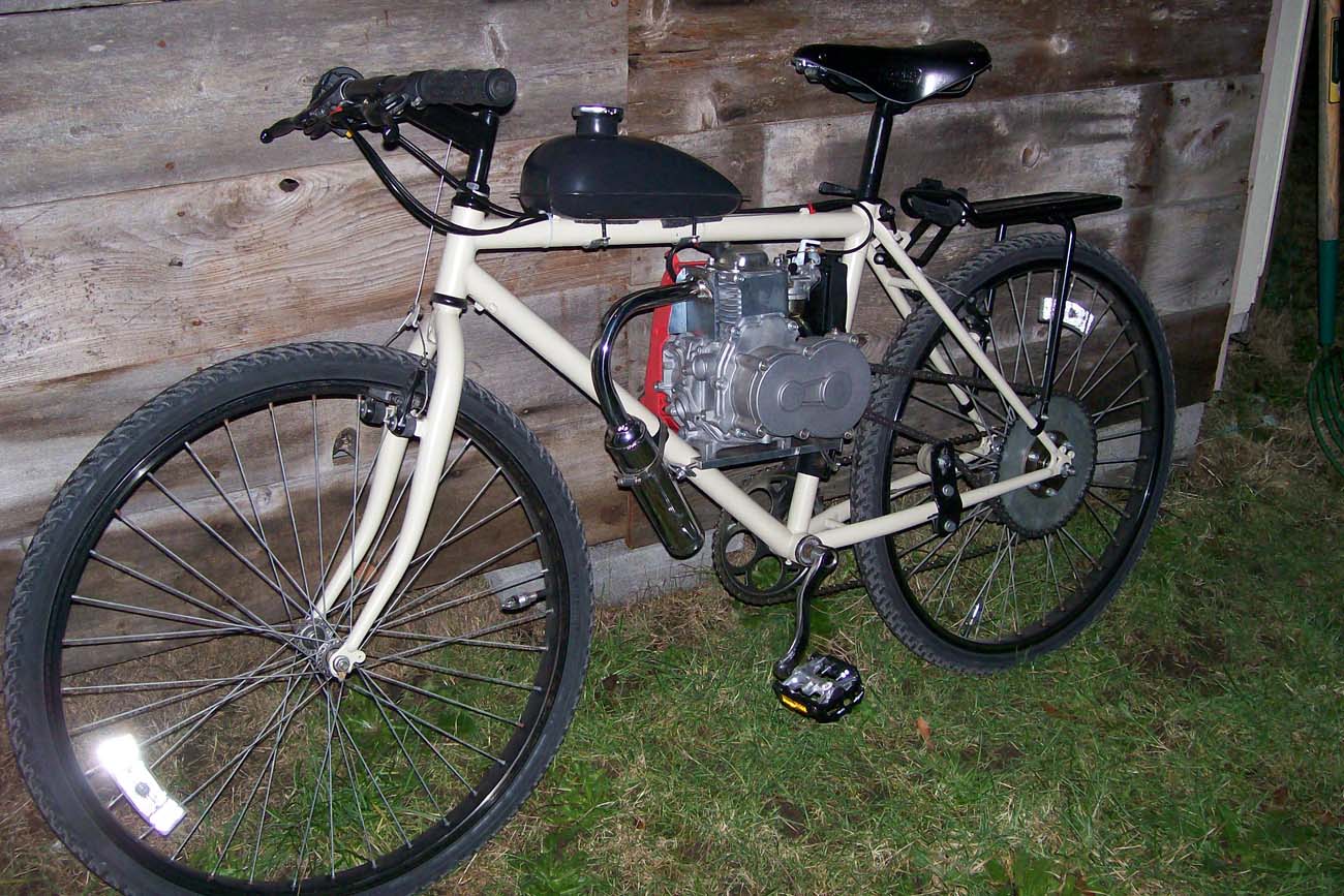

I am aware that most don't think the hoot is worth er.. well.. a hoot. But I think that there are a lot of people sort of stuck w/ them unless they want to junk their kit and start over.
I don't anticipate buying any more hoot kits unless they prove to be reliable w/ my rebuild. I honestly have no idea how many people have these gb's.
I rebuilt mine and it is now very quiet and I'm going to ride it and check it to see how it is doing regularly.
So if anyone is interested, I will rebuild for free (you pay shipping) 4 hoots for the 1st 4 people who repond. This way I can get a better idea if reworking the clearances will make enough difference.
Also if anyone has working hoots that they don't want I will pay shipping to get them. I would like to try heat treating the gears and testing that as well.
PM me or reply to this thread, Thanks! The bike pic'd has a hoot just in case you don't know if yours is one.

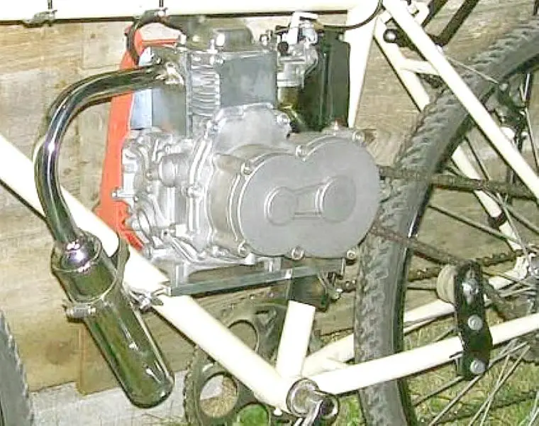

I've wondered about the Hoot's, heard them talked about here. It's my first time to take
and up close look.
I took the photo TS posted and went in close on it to examine it.
Here it is for others benefit.
