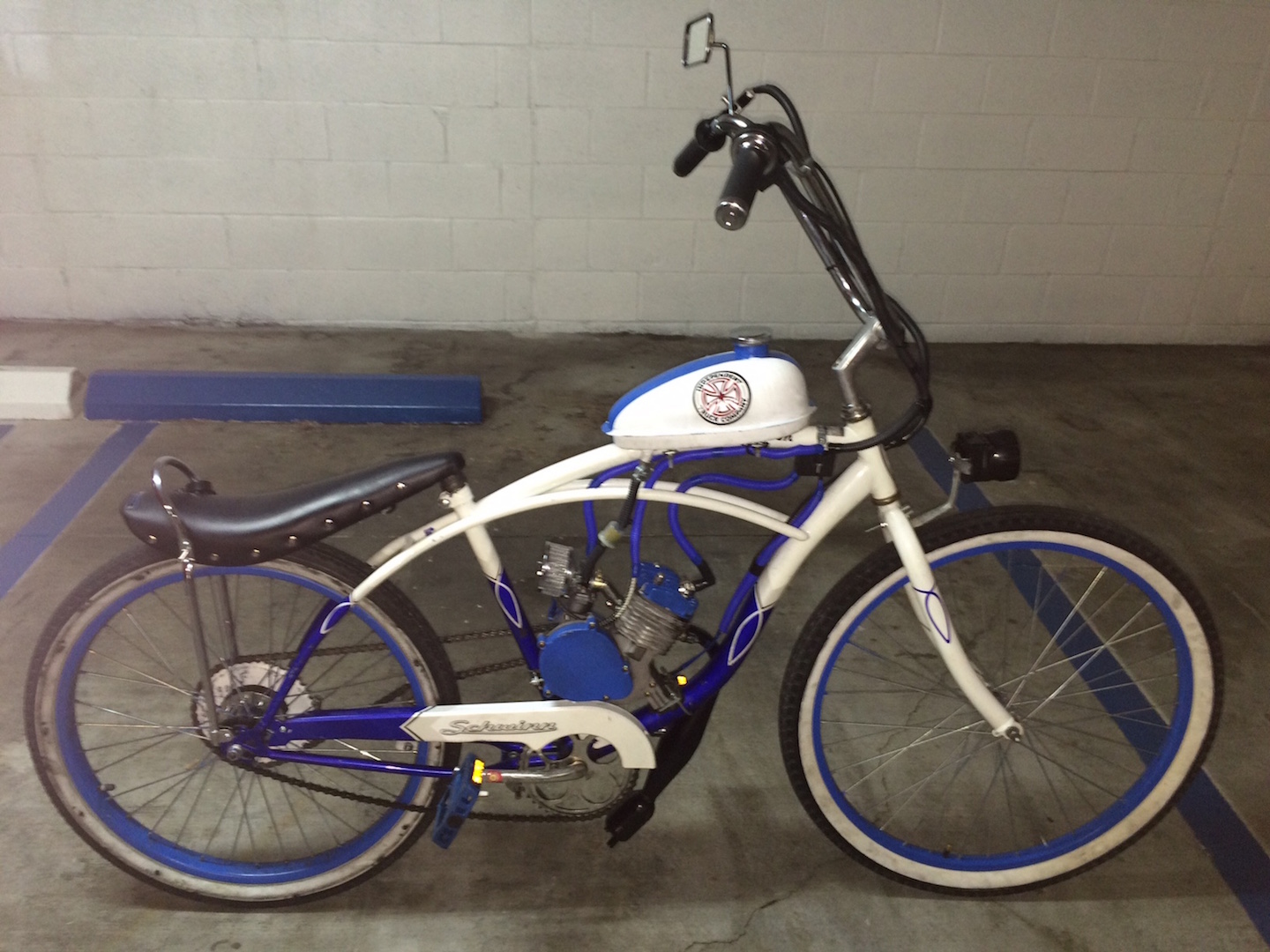

Hello everyone,
I've been lurking around the forum for a while and decided to finally start posting.
This is my second build and hope its the second of many!
It started with a schwinn typhoon which I got used for about $75.
Found a dude on the list of Craig that sells the motors for $185 (was not aware they won't ship them to ya here)
Made the 20min trip, picked it up and it was on! I painted the engine head, clutch, magneto and engine sprocket cover, motor sprocket, gas tank and that piece of crap we call a chain tensioner laff
Im going to paint a spitfire skateboards logo on the gas tank but am debating either learning to weld, paying someone to weld me a tank or buying a very small motorcycle peanut tank... because I really, really want a peanut tank.
I really like how the tank starts small and skinny and ends tall and square. it puts the tank right around chest height and the look just tickles my fancy... a bigger tank then the 2.5L would be nice too I seem to go through tanks like nobody's business.
it has a 24 x 2.215 rear wheel and a 26 x 1.75 front wheel.
I also added some ape hangers and a banana seat for a more exaggerated bobber motorcycle look. The banana seat was a little too high and not far back enough for me so I went to home depot and used a 5 in 3/4 threaded steel pipe, a 90 degree elbow (3/4 to 1/2) and a 4 inch 1/2 threaded steel pipe and made myself a bent seat post. flipped the little latch that the seat post connects to the seat upside down and was able to put the seat more or less where I wanted it.
Hope you guys enjoy it!

Here she is. I really like the way it has turned out.
I just installed the ADA air filter and short expansion chamber but haven't had a chance to take a photo yet.

Suweet build, RS.
just to add to the above...
Tanks can be pricy. BA did a cool DIY thread. http://motorbicycling.com/showthread.php?t=17323 Ya cut out what you want for a tank then have it welded. At the end are some ideas using alumiweld, which is amazing stuff.
But if ya search around there is a lot of other ideas, too.
If you get the opportunity, learning to weld is a blast and then ya can do some amazing stuff. No matter what you decide, try and learn welding.
Build some thing cool!

Here is an update to some work I did the past couple of days...
Added a Independent Skateboard Truck Company sticker to both sides of the gas tank (Im waiting for some blue Spitfire Skateboards to arrive at the local shop but couldn't help myself) 1/2" wire loom which I wasnt sure about at first but actually ended up liking how it fills the space and makes the bike look more beefed up.
I am also in the process of getting it registered so I got a left side mirror, getting one for the other side but there was only one with the blue reflectors.
Tomorrow I am off to buy some brillo pads and using it as a sponge with detergent to get those white walls white again. Friday I receive a 300 lumen headlight with a small red light for the rear, Analog speedometer and tachometer. Cannot wait!

RS, Lookin' Goood!
Did ya clear coat the stickers? Can get fuel resistant spray can stuff.
Forgot! Brillo might not be a great first option. I use any sort of gojo shop hand cleaner. Put some on by hand and rub it around. (I let it sit for a while) Then just wipe of with a rag or paper towel. Brillo will leave scratches where grime and schmutz will collect easier and looks ruff. Just my VHO. Hand cleaner really works well. But I am sure there are other options, as well.
And, white walls are gonna need cleaning a lot. Kinda a PITB but looks so good when clean.
Seriously though. Bike is looking Good.
