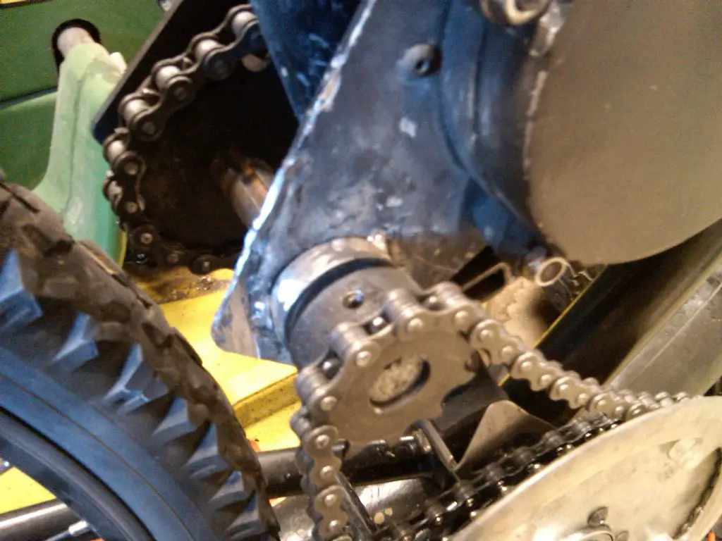

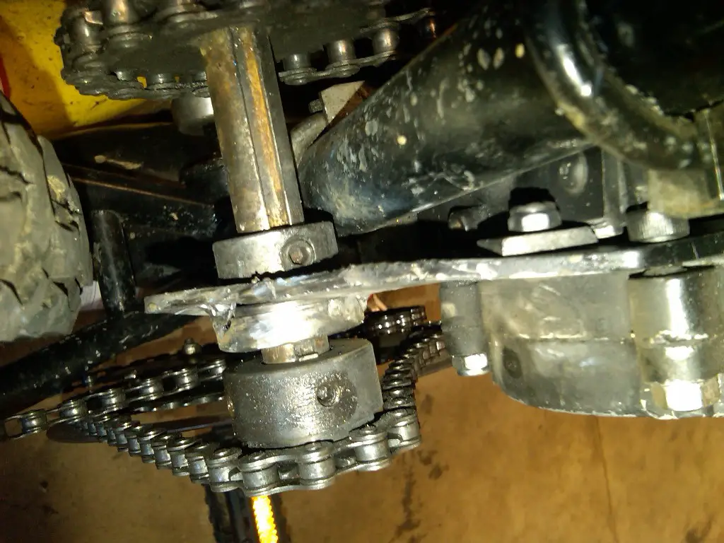

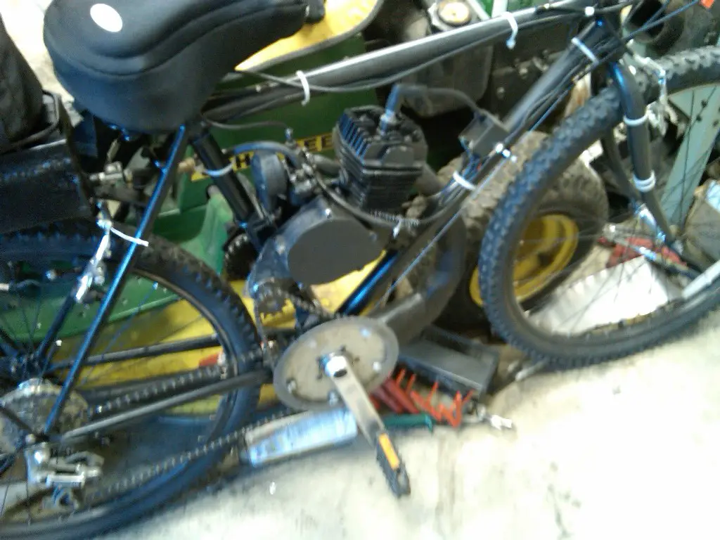

Sorry for the bad photos. The bracket was bent a little more severe before because I tried to bend it straight again and spot welded the bearing in place just to try to see what was goin on with the plate... You can see how slack the chain is from the bend in the plate...

wow, how did you manage that one? Is your motor really producing that much more power? (if so, HOW) Or could it be from a misalignment of the plates causing the jackshaft to not run perpendicular to the side of the motor?

no idea but i know i followed all of the directions and made sure that the plate was perpendicular to the engine... and both plates were parrallel... The only thing i didnt do was install one washer under one bolt on that plate but the bend in the plate is about 1.5" away from that bolt so i dont think thats the problem. The aluminum bracket is installed too. I think I will weld some extra steel to the area once it is again straight...
