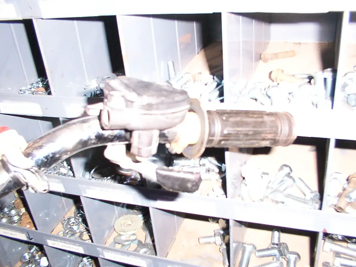

I use a ATV thumb throttle.

What I wanted to edit was I forgot to tell you guy's that if you use a ATV throttle. You will have to make a sleeve because ATV handlebars are bigger then bicycle handlebars. I just used a piece of coppertubing because it was all I had on hand. Cut to length, cut down the middle and slip over handlebars.
