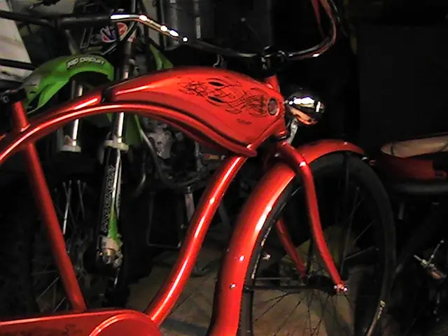

I saw an engine with the fuel tank behind the rider seat. Looks like a bike bag. Seems like a smart way to do the tank, and have a little more stealth. My concern is stealth. Having enough covers to not let anyone know you have an engine, when the engine is turned off. Cover it with a black zipper bag (canvas, etc.) and let people think it is just another bike bag, on the bike. Wonder if I could get my local bus to carry the bike, not knowing what it is they are carrying.
The tank is on a bike for the front page of SICK BIKE PARTS.
