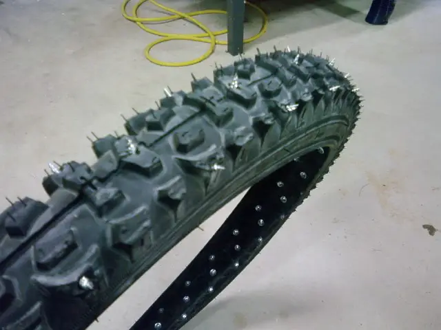

I wish i could say it was my own idea, but plenty of others have done this.
I got the deepest-tread knobby tires i could find (pyramid $30/pr), and got a bunch of #8 X 1/2" lath screws with super-large flat heads for $5 .
drilled (using a very small bit) down from the center of chosen knob into the tire. drilled screw up from inside-out. if your angle isnt pretty correct, it'll stick out one side or the other.
be prepared to have plenty of time to do this...its tedious and time-consuming.
dont try drilling all the holes, then installing screws...you'll drive yourself bat-s**t, trying to find which knob you drilled.
i thought about the side-to-side play, and the screws wanting to push back into tire.
thats why i opted for the lath screws....really flat and alot of surface area.
with two tire liners taped side-to-side, getting the tires mounted on the rims was a nightmare. ive never actually wrestled a rabid porcupine, but i think i know what it feels like.

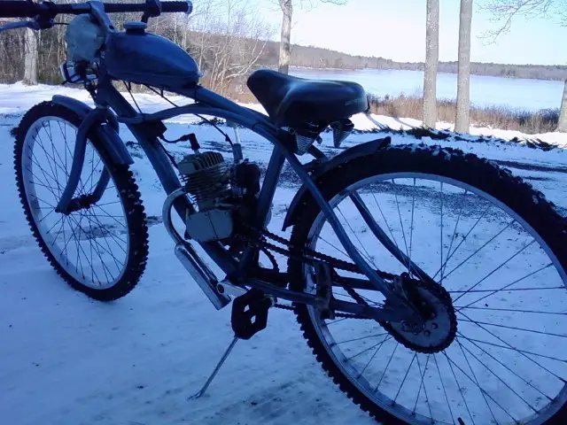

rode today, and THESE. KICK. BUTT-CHEEKS!!!
our driveway is pretty long, up to the pavement. packed with snow/ice, and they performed very well. i went off a little into some deeper powder, and the rear did slip sideways just a little bit under power.
going to have to swap out my 36tooth for a 44.

Nice looking setup you could use some rubber glue on them when you put them in might keep them from popping back thru

as far as them pushing back into tire, i think with thorn-resistant tubes along with the mr tuffys should do the trick.
rear tire wasnt seating well with two tire liners side-by-side, so i'm going to go down to a single.
