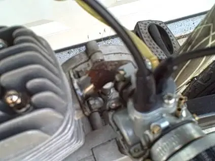

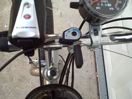

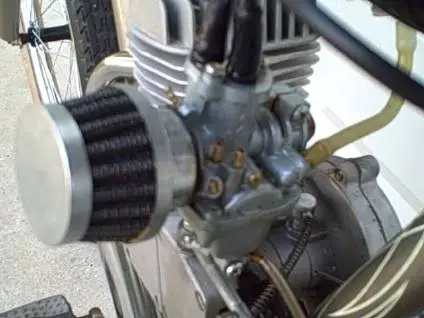

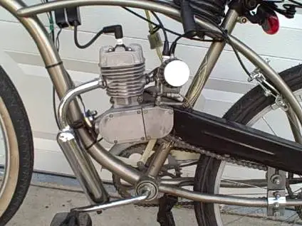

I just finished editing the pics so here they are not the prettiest intake but it works.
The pics show the carb make sure if you make a custom intake that it clears the Clutch arm mine is very close but it sit just above the mark and the clutch works just fine.
Also i would recommend polishing the crap out of the tube to help with airflow but this setup works just fine
As i said before just having a air/fuel adjustment screw is worth the price but the remote choke is a bonus.

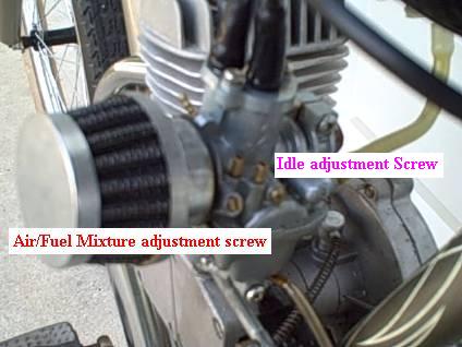

To be honest i am still fine tuning everything in but what has worked so far is to start the bike allow for warm up before any adjustments. unless it is racing then back the idle down. After warm up...
1. raise the idle up some to allow it to breath
2. adjust the Air/Fuel adjustment screw in (clockwise) until the motor begins to stumble.
3. Back the screw back out 3 full turns (anti clockwise)
4. Lower the idle back to normal rpms
These settings make for a rough cold idle but IMO thats the sign of a proper warm motor setup use the first setting of the remote choke at first.
Saying that take in mind that i am in Florida and nearly at sea level but those settings should get you close enough to make fine adjustments. I have noticed a big difference in performance mainly in middle rpms i don't really run WOT i keep it in the power band like a 2stroke wants to breath. Higher altitudes will run leaner than lower altitudes i believe but we all love to tinker so make an adjustment try it out.
I use a felt tip pen (sharpie) to mark settings i like on the carb body makes for easy setup as temps can vary 30* in 24 hours
DISCLAIMER
I am not a professional mechanic and this information can in now way be held against me. I live by the creed if you don't know what your doing a $5 tip normally gets some help from someone who does.
