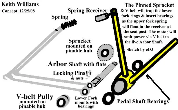

I have just come in from a very successful shop session and feel higher than a kite. I was working on my Monark with the 3-speed jackshaft and ideas kept flooding my mind. I glanced at a pair of Motobecane rear coilovers and rear suspension came to mind. Most of what I have seen attempted didn't pay much attention to chain slacking as it swings. Try this---Take the crank out and find some bearings to replace the crappy peddle ones, maybe some with snap ring grooves can be found. Anyway, pass a straight shaft through and put some flats on it to bolt lightweight-style peddle arms parallel to each other using the wedge bolts Slip tubing over them and weld for a swingarm.
Outboard of this, a sprocket to drive the rear wheel and a pulley from the motor belt on a bearing arbor rotating on the swing arm shaft. The chain will always be at constant adjustment. To go fancier, use needle bearings and run the swing arm off the small shaft and put the engine drive in one side and the sprocket on the other on a rotating tube containing the swing arm shaft. You could use a derailleur system if you wished. The upper rear fork would be a front fork with a valve spring sliding in and out of a pivoting receiver behind the seat post. A milled slot in the fork would control its travel limits with a pin or perhaps simply use the fork nut in a pivoting yoke to limit the retreat of the fork stem. It would require pivot bolts at its connection with the swing arm. This system would eliminate any side wobble in the rear wheel. So much for that. Here's what I accomplished. The Hodaka tank I mounted has 2 fuel cocks and I intended to simply wye them together and run to the carb through a filter. Fine, but one cock barb was about 1/8" from the muffler, which attaches at a funny angle, so I pulled the muffler to see if I could invert it. Nope, it interfered with the 2nd jackshaft, and also the engine port is a D shape and somewhat larger than the round muffler flange. AHA Back Pressure! I made a 1/4" thick plate and used some 1-1/4" trampoline support with small radii bends to fashion an exhaust pipe.

Since we don't have any photo's as Keith's concept is in development, I illustrated
it with a sketch for him. Understand, this is how I see it to work and I think
it's an interesting solution to several problems at once. A centrifigul clutch on the motor's
output shaft could drive a V belt to the Arbor Shaft where a pinned V belt pully would turn
the shaft thru the floating lower forks riding on it. The pinned sprocket at the other end could
then drive the rear wheel's sprocket without real need of a spring loaded chain tensioner.
The pinned sprocket hub & V belt hub would trap the lower fork mounts securely while the
upper fork spring would ride securely as Keith described in a receiver mounted to the seat post.
the down tube in the sketch may be modified in the finished form to provide a platform for the motor
and foot rest.
With a good springer front end and the floating rear suspension I could see this platform capable of
using a 6 hp recoil start motor and have adequate power to start off on motor power and take you
about anywhere you would want to ride.
Interesting ideas and clever solutions Keith !
Considerations I see:
Good reinforced welding of the rear forks, and larger rims & tires suitable to the speed that will be
attained.
