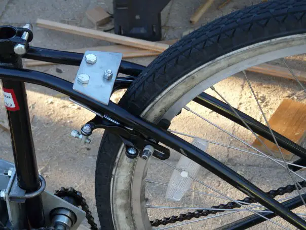

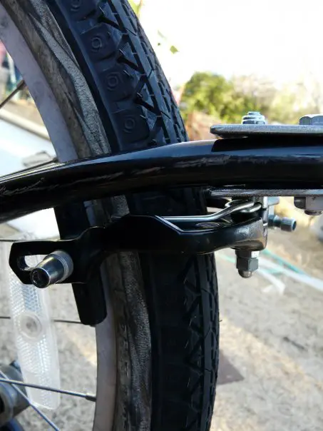

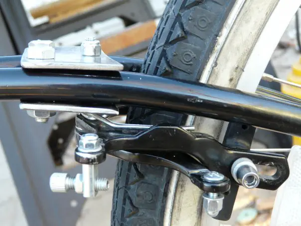

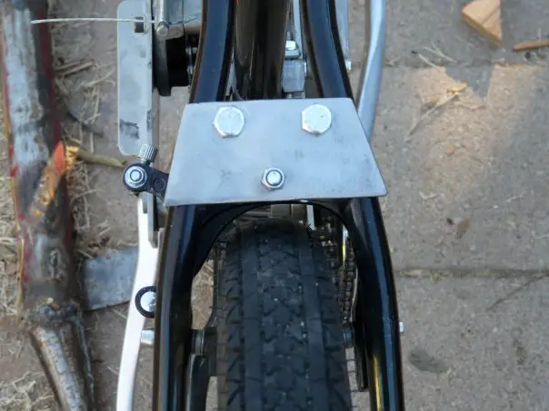

Just wanted to share some pictures of the rear brake set up I made today. I built it because I am in the process of installing a shift kit from SBP and I can't use the coaster brake anymore. I was amazed how nice it came out. It sandwiches the frame and can be adjusted by loosening the bolts and sliding it forward or backward.
Thanks for looking,
Andrew

Is that a 3 speed hub you got there? Nice and clean,man.

It's actually a nexus seven speed. I can't wait to have it up and running again, the seven speed was fun on a regular pedal bike I can't imagine how much fun it will be with a motor.
How could you tell it wasn't a derailleur?
