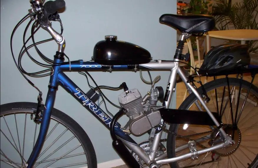

I just finished putting an 80 CC motor kit on my Trek mountain bike:

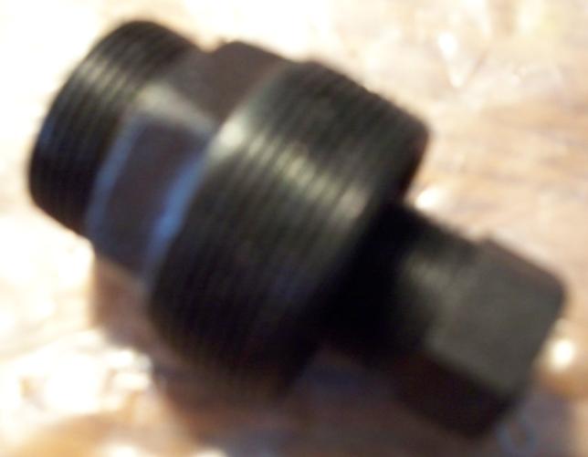

I have a mystery part left over. Anyone know what this is? (sorry for the blurry picture, my camera won't zoom):

Also, the motor doesn't allow the back wheel to turn freely.
Any help is much appreciated.

Hello and welcome to the forum!
That thing comes with all the kits and is the doohickey you use when you pull the gear for removing the clutch. There's a thread on this forum for using it and, by golly, I can't remember where it is.......someone help me out.
Do you mean when it is running? When the clutch is squeezed, the wheel should spin freely.
Don't feed the bears....
Old 12-19-2008, 07:36 PM
Technocyclist's Avatar
Technocyclist Technocyclist is offline
Join Date: Jul 2008
Location: Asia
Posts: 415
Default Re: Help for a newbie
Welcome to the forum... If you squeeze the clutch lever, the rear wheel should spin freely. If not, the chain might be touching the crankcase or you need to adjust your clutch cable or the clutch itself...

Eric, Welcome to THE forum. That gear puller is something you might to hang onto. To buy one is about 16.00 usd.

Here is a post thats shows a video using the clutch/ sprocket puller that you posted a pic of..........
http://motorbicycling.com/f3/who-jig...-kit-1605.html

Thank you everyone! Now I know what that tool is for, and I downloaded the video in case I ever have to use it.
The clutch cable had too much slack, so it wasn't operating the clutch arm. It engages now and the wheel can turn freely.
