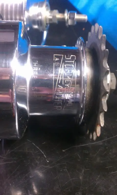

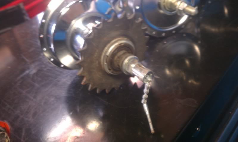

I figured I'd keep an eye out for a Sturmey archer 3 speed, as I have been considering a shift kit. Scored one on craigslist today, and got a bunch of great stuff too. The hub appears to shift through the gears, and freewheels. Its a AB hub.

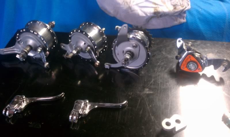

I don't know jack about any of this stuff, but I wanted a drum up front for a while, so that is an added bonus, the other drum has a threaded part for a sprocket. I can't find a name on the one drum, just japan but the rear one says arai on the lever.

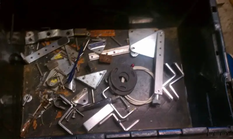

A super cool guy sold me this stuff for $30, plus a nice bin full of odd brackets and metal thingies that may be related to these parts
Think any of this is worth using?
Front drum brakes work well and give your motorized bike the vintage motorcycle appearance. The vintage disc caliper looks cool, but it will require you to get a front disc hub and rotor. Many members have said that a motorized bike with a shift kit and seven spd derailleur provides more gear ratios than necessary, while a good 3 speed hub seems adequate.
Yeah, I'm sure that caliper is going to sit for a while. Most importantly I want to address the hub. I've heard plenty of both good and bad about them. Ultimately, the price of the unit has made it possible for me to find out just how good or bad it is personally. All the other stuff I got was just an added bonus from a guy who had bought a "box of bike parts" from a neighbours for an even better deal than I got. I even got to keep the box itself. Guy said the neighbor died an

I have looked everywhere for a date code on that 3 speed, and can't find one? Every other one ive seen had a date right under the model.
Looks like you've got a set of reproduction Dia-Compe or Weinmann brake levers there - I've got a set of beat-up originals that I'll be using on my build. I believe they are early 60's style "eye-stabber" levers that came on Krates & such before they changed them to the style with a rounded tip (I guess in an attempt to keep people from gouging their eyes out with it?), and usually they are found in the "gold-dot" or "red-dot" variety (the "dot" being the cable retainer), though Fairladys with pink-dot eye-stabbers can be found as late as the 70's. Judging by the color of the hardware, it looks like you've already got an original brake cable in that box suited to red-dots which is a nice score. I don't know a lot about the rest of it, but just from what little I can identify from that lot, I'd think you got a solid deal there. ...but all that's just 2¢ of a ½ wit, and hopefully someone more knowledgeable than me will chime with corrections where I may have got it wrong. :D
I'll have to take a closer look. They have a button like a clutch lever or a parking brake? they don't appear to have been used ever. That cable has a little red anodized retainer thing on it, that made me think it wasn't very old, but I was never around those krate bikes.
I'm leaning towards the side that I got a good deal on this stuff too. I'm still stumped on the lack of date on that hub though.

I went digging for pics, and discovered I may be wrong about the brake cable. Now that I've seen what the originals look like, it too may be a re-pop, but still very cool. These are the eye-stabbers I was talking about in red-dot:
This is a pic of a gold-dot with the rounded end:
I'm not sure exactly when they changed them up, but if I'm not mistaken, the eye-stabber is an earlier design, however, it carried through into the 70's as a pink-dot on lady-bikes, so..? - not sure. As you can tell, I'm no expert, but I tend to accumulate tid-bits while lurking online.
A PDF manual for the AB hub can be found here http://vancruisers.ca/tech/manuals/sturmey-archer-service-manuals/saab.pdf/view
It's an older Sturmey Archer design and was commonly used on English heavyweight bicycles. My 60+ year old Hercules Ladies Heavyweigh Roadster bicycle has one and it still shifts very sweetly. The thing to watch with them though is that the brake linings can easily get contaminated with oil if you're too generous with the oil can.

I have found online that during wwII sturmey did not date code anything. Is it that old?
Yes it's very likely that your hub is that old :) These hubs were mostly used on 28inch wheeled heavyweight bicycles and they seem to be fairly robust.
If only it could tell its story. It sure is clean though, I can't see wear on the gear or spoke holes, or the brake cable arm but it's built well so maybe I shouldn't. I'm excited to take a look in the drum. If this was used much in it's life I'd be surprised. Or it had an impeccably clean owner, or a kid with a polishing wheel shined up a turd extremely well. idk.
