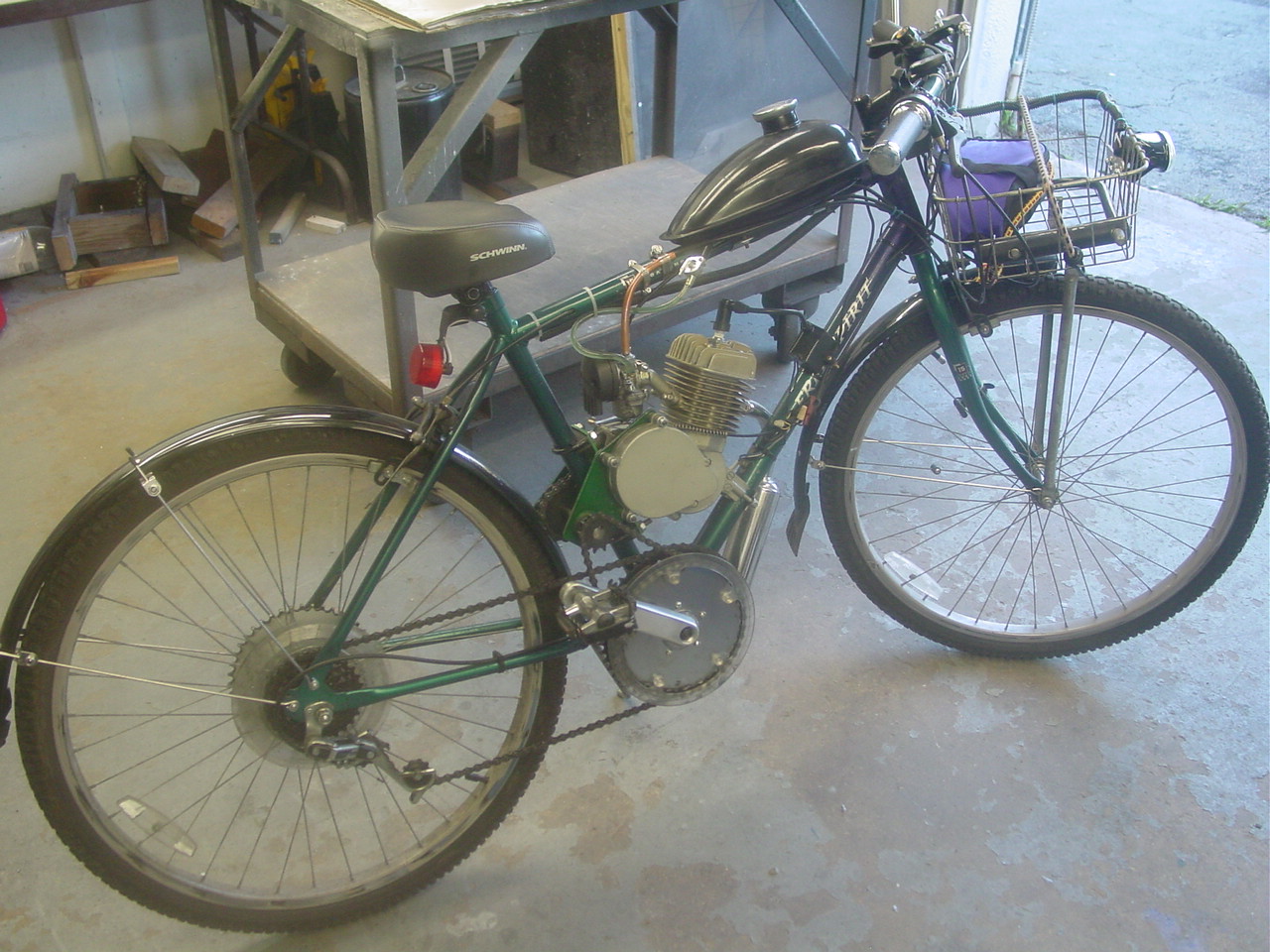

I have a slight drag from the chain and clutch mechanism. I use the SBP shift kit. Their parts are the greatest. Also I rarely pedal.
