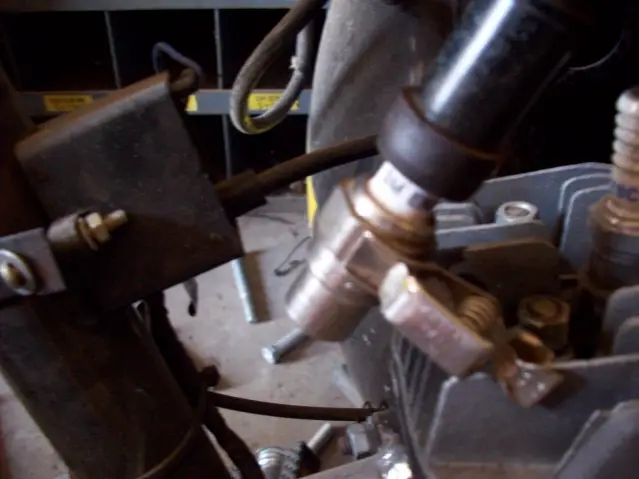

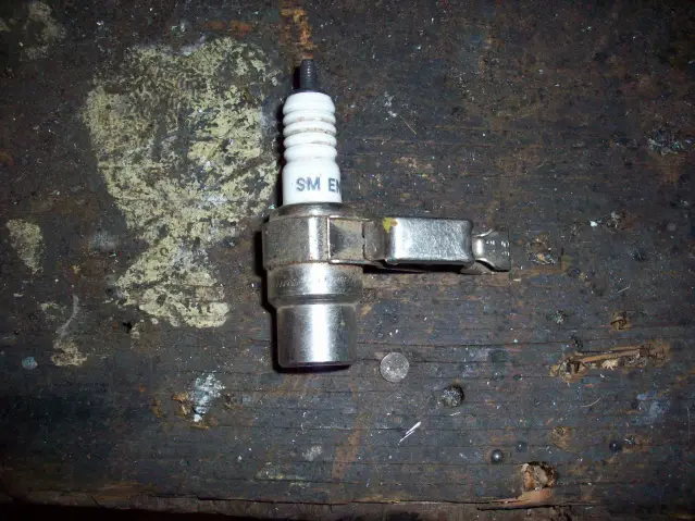

Testing for spark by yourself can be a pain....
http://motorbicycling.com/f4/tester-ignition-207.html
I use a spark plug tester that can be picked up at any local auto parts store. Normans set-up is a lot easier to make.
You can also make one like I have with a old spark plug and alligator clips. Just solder the alligator clip to your old spark plug and there you go. Be sure not to crank the motor without the coil wire plugged in and spark plug grounded.
