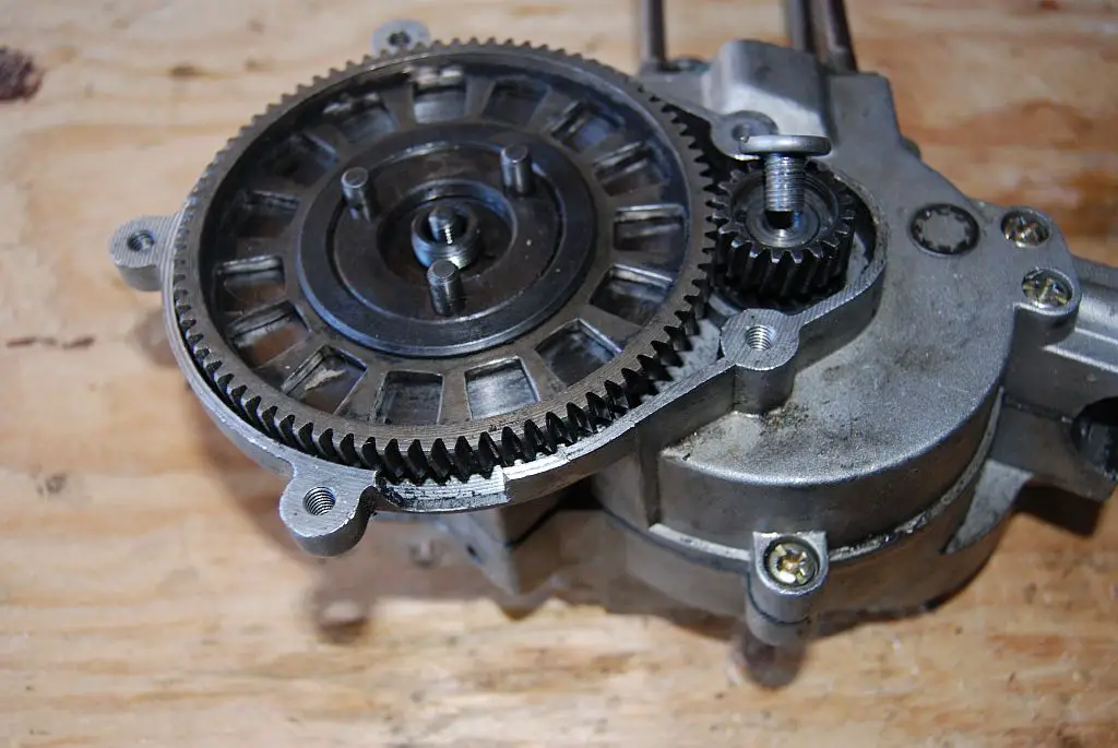

The woodruff key rattled out on a friends bike and knocked a hole in the flange on clutch side of his motor. The vendor he got his kit from is not willing to fix the issue.

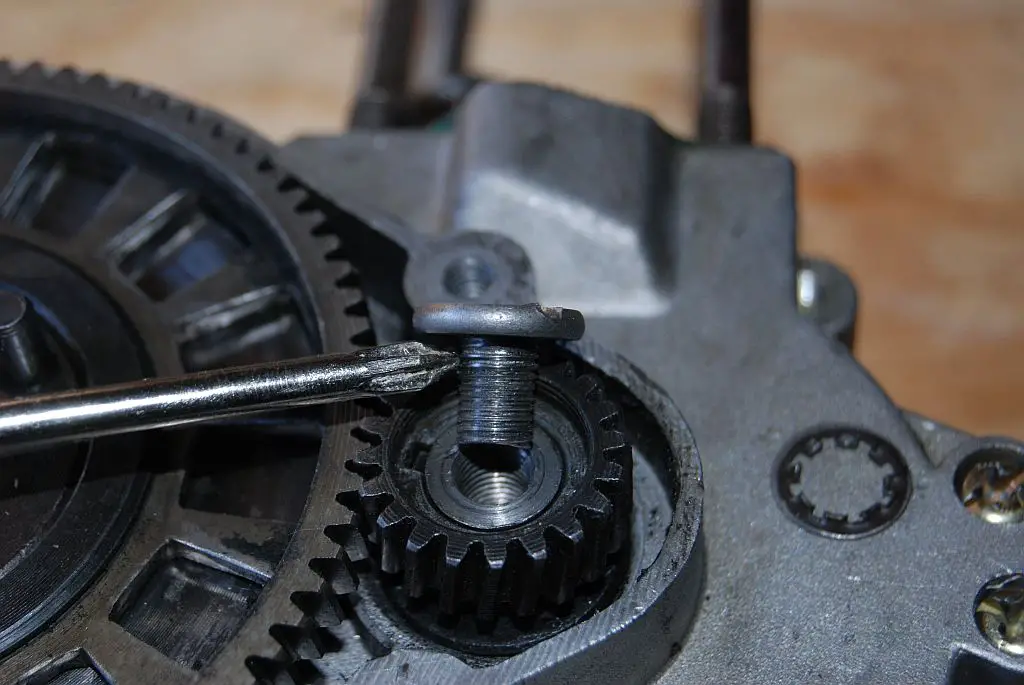

Attached is a couple of pics. Damage was caused by a galled screw thread on the crankshaft pinion that did not tighten up properly and allowed the pinion (sometimes called bevel gear) to float and the woodruff key to come loose.
Does anyone know a vendor with the lower unit in stock?
Thanks!
James

Is there any other damage besides the missing key and that hole? You should be able to find a new key, and the hole is really only cosmetic....
I haven't seen any lowers for sale, you'll probably just have to buy the whole motor (sans kit). I think you can get one for like 90 bucks from thatsdax.

I have already replaced the key. I thought that the clutch ran wet on these motors? I was scared to induce an air leak into the motor.
Turns out the vendor might be somewhat helpful when it comes to getting me parts. We shall see. Waiting for a reply back from him.
