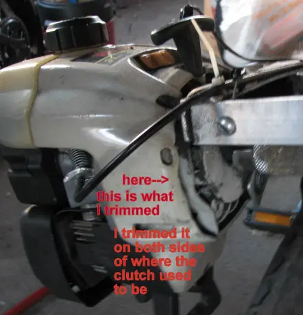

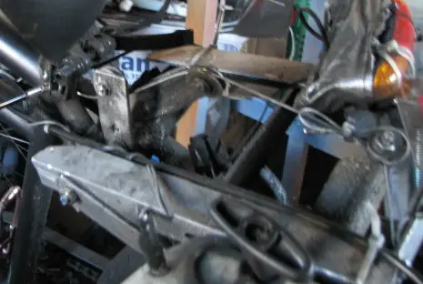

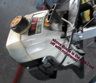

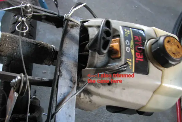

alright I hope these pics help.
On either side of where the clutch is or used to be in my case, I trimmed the shroud or case of the whacker down with my dremel tool. You could use a grinder, rotary tool (not safe), or coarse sanding drum. You want to grind the plastic down so that the whole front of the case is flat and flush. this way you can keep your pull start and the cooling effects of the case.
Let me know if you have any questions
