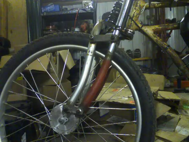

Tonight I made and profiled the link plates and top plate. I still need to get shoulder bolts. At this time it is held together with 3/8 and locknuts. I found it would work with the Schwinn drum brake and I think if I don't bolt the arm down like on the yellow bike and allow it to centrilize, it might be good. I will fill in the slots so the bolts can't escape , or just use safety lug washers. The big suprise came when I realized I can suspend a damper plunger from the gooseneck and put an oil seal under the top nut on the fork. A 1" o.d. x 1/4 id seal will be a snap to find. I can put a vented head on the end of the plunger with a floating sleeve to shut off the reverse flow on the rebound. I really don't think I will ever appreciate the damper, but I gotta plug the hole with SOMETHING> An O-ring is my rebound cushion at present. It will take some contriving to put a fender on it. I don't like the short fork steering tube, but I will probably just recover it and do a whole frame from scratch as soon as I decide on a motor. The rear fork is a 24" and I don't have any others, so I'm stuck with it. The fork is copied from a PIERCE, not a Pearce Cheers to all,

Notice I finally got some jpg courtesy of Picassa 3. I told Snapfish to get off my galaxy If you can't make it work, back to the drawing board. Sound off

this is a picture of the first one I have done
as you can see I just hacked up 3 forks & sorta welded them together
it works pretty well :-) tracks nice, steers a little slow so it feels really stable at speed

Jak- I only see 2 forks and what looks like fork legs headed for a triple clamp-? What hub is that? Looks good and ought to be real stable. Send me your email and I'll show you whats happening here. I think next I will mount the chrome Hodaka Ace 90 tank on the 3-speed yellow bike. The gas guage cratored on the Jiang Dong and left me a 1" hole in the top. I was going to use a peanut tank but it is rusted out. Keith

the rear fork is made of two
the upper with the tripple tree
the lower legs are from a red fork I bent
the forward fork is the third :-)
