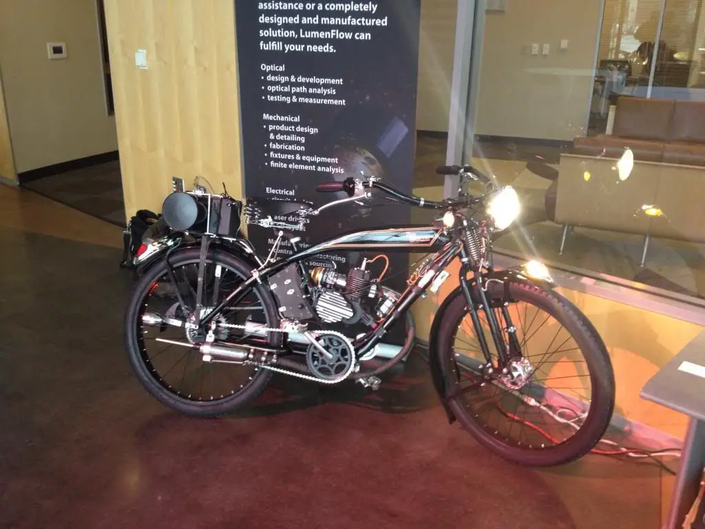

I got what I believe is a Felt frame with the gas tank built into the frame primed but needs a little work. with 1 and an 1/8th inch head tube. It came with a 24 inch rear aluminum rim with a S.A 3 speed coaster brake hub its the SRC3 with a 3inch Thick brick tire and a 26 inch front rim with a Joy industrial co. LTD Drum Brake and a Quick Brick 2.125 tire all stored correctly and not to old, no cracking on the rubber. 2 extra rear tires, fenders, chain guard, rear rack, and two parts of a springer front fork I just need the spring and fork bar I guess it would be called that goes through the head tub, local shop only has 1" can't find 1 1/8th locally. It also came with one piece cranks, some chains, one for the bike. Also I think a 415 or 420, and a muffler. I traded it all for a pressure washer that I got for free from a friend. I think I came away with the better deal.
I have some questions? Is it a felt and if so what model and how old? Or if not what is the thing? I attached pictures. Please if someone has built one or has a link to a finished one so I can see what it looks like built. I know its kind of a clean slate and I could go a lot of different directions with the build but I just would like something for a reference. Also I am wanting to go with a Jack Shaft and a 80cc motor with a Fred's head with pressure release valve, a dellno carb. or whatever its called... I am also going to balance the crank shaft and lobe within acceptable tolerances to reduce vibration. My question is, will that hub hold up against that kind of motor? I like the idea of 3 speeds without a derailleur. Astatically that would be very clean. But I have some concerns with life expectancy and such with the hub.

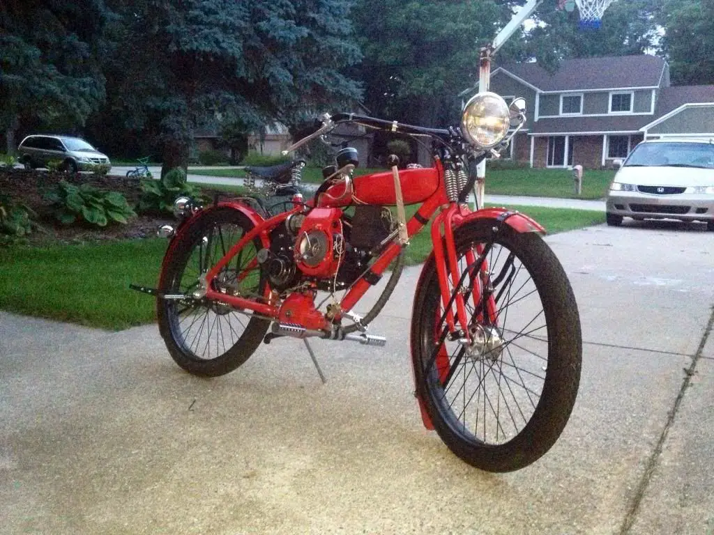

I included a picture of my first build a Diamond Back Della Cruz 1 it has the 1 1/8th head tube springer front end like the one I need for this one. I port matched the intake and exhaust and put a expansion chamber with a little muffler on the end so its not as loud those three little mods about doubled the top end speed. I just need to lengthen the intake for a little more bottom end torch. and...and.....and.... I am always wanting more lol.... does it ever end? I hope not, building these things is half the fun.
