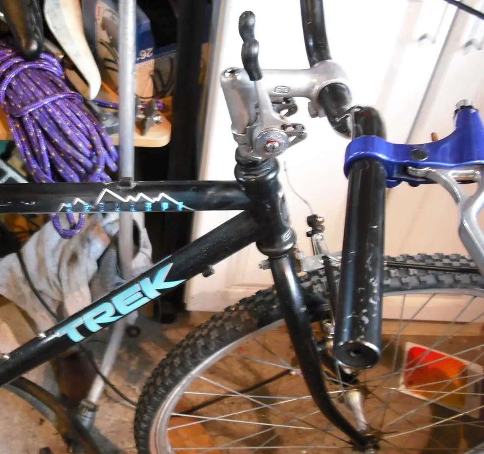

So I really wanted to make my winter build with a mixte road frame from the late 70's or early 80's, one of those step through frames with the double top tubes. I'm still scouring clist looking for one and if one comes up in my price range I'll jump on it fast, but as of yet, I've got nothing.
Instead while perusing clist I found a listing for a free Raleigh (1980) reliant and a TREK 800 antelope (1991). Both are from a local bike shop and in varying condition.
My garage had, at the time of bringing them home, 8 bikes in various states of (dis)repair... I finally sold the 24in Haro I had wanted to use for the build, but was far too small for me to ride with any comfort. I wish I had kept the components off of it.
So I have to consolidate... That means getting rid of 2 of the bikes left (7 total), pillaging 1 for parts so that I'm left with only 4.
I decided that I would strip the Raleigh down and use the parts on the TREK to make my winter build. The Raleigh has some useful parts that are much nicer than those on the TREK. I'm also pillaging parts off the blue 'Ray I've all but ruined...
I have stripped the Raleigh down to all but the crank, which I will be using on the TREK. I took the neck off the raleigh, with it's Suntour shift levers (very nice and functioning very well) and swapped it out for the TREK's neck. I liked the lines of the Raleigh neck better. Plus it is aluminum and looks nicer. Swap was fast and easy.
I've stripped all the brake levers, shifters and cables off the TREK. I'll be able to clean the frame and sand off the lame Antelope logo so I can cover it up. I may or may not call this the MadWagon 2.
The TREK is just the right size for me to easily get on and off. I can stand over it without being on my toes. The motor will fit in frame or on the back easily.
I'm planning on swapping the crank and gears out for those on the raleigh... Essentialy I'm using the TREK frame with broad tires to put a road bike's crank and gears onto. I"m going to see if I can get the freewheel from the Raleigh on to the rear hub of the TREK. I'm also considering using the SunTour GT components that came off the Raleigh. The Shimano Exage are carp, pure carp. While thy function I don't like how they look or how the shifters work. The inside of them are metal but the exterior is cased in plenty of plastic.
I'm using an Echo weedeater as my motor. Engine runs smooth, sounds great,but is low on the CCs coming in at only 21.2cc. I'm going to use a jackshaft and gearing.We will see how it goes.

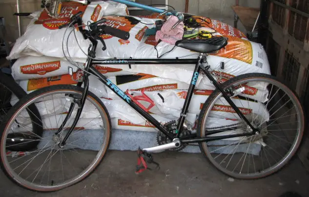

The pic below is of the TREK before modifications and changes. It's not pretty but it's a solid frame is relatively good shape. Few scratches and no rust to speak of.

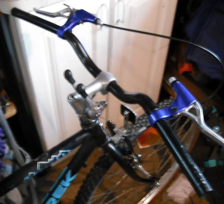

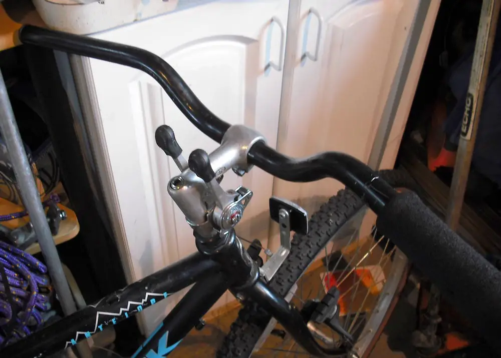

Anyway. I shoveled the walkway and headed to the garage to get a little more work on the TREK done. I managed to easily get the brakes swapped, the blue 'Ray's brakes fit perfectly and look a lot better than the brakes on it. I also pulled the brake levers from the blue 'Ray and they work well, but are the wrong color. I'm not sure what I”m going to do about that. I'd like to get grip shifts for the bike, but the issue is that if I use the old Suntour gears I won't be able to use an indexing shifter I'll need a friction shifter. Though I suppose I might be able to jerry rig something.
Road gears are bigger than mountain bike gears. With the taller road gears I might actually be able to help the engine as I pedal. The goal is to use the mountain bike gears on the jack shaft. We'll see how it works.
So far I'm still happy with how the bike is looking.

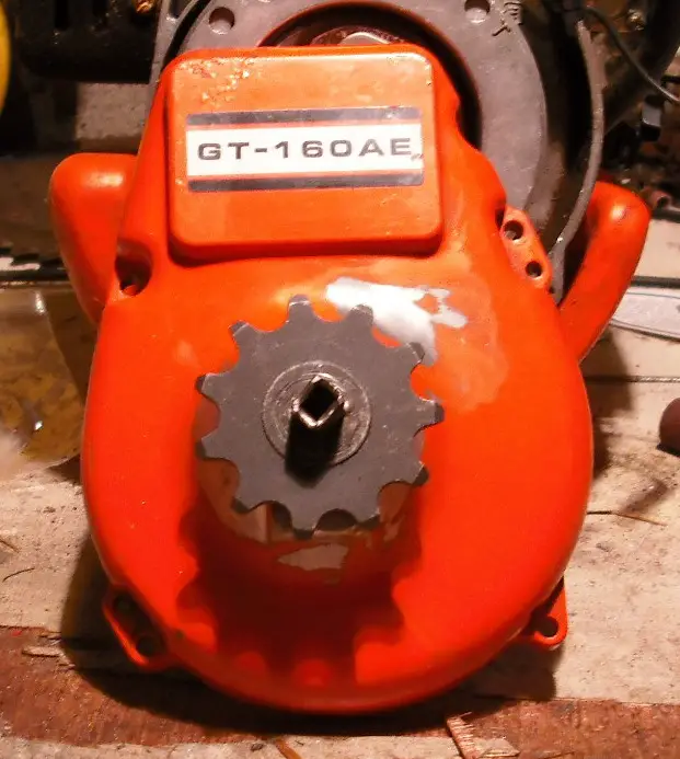

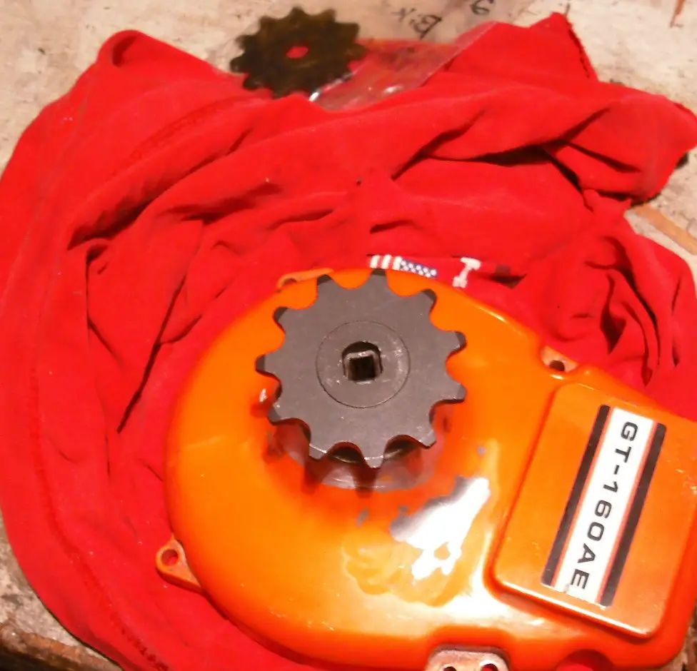

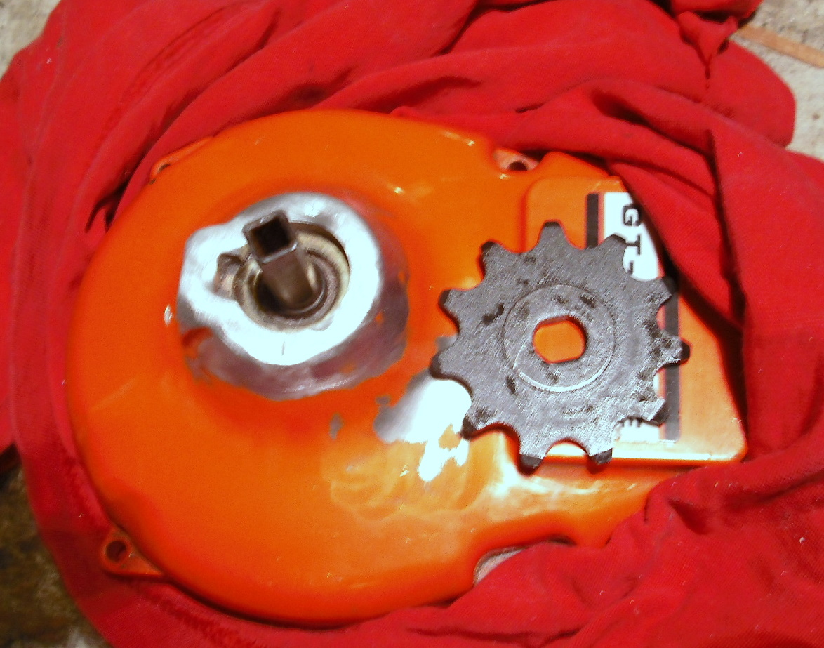

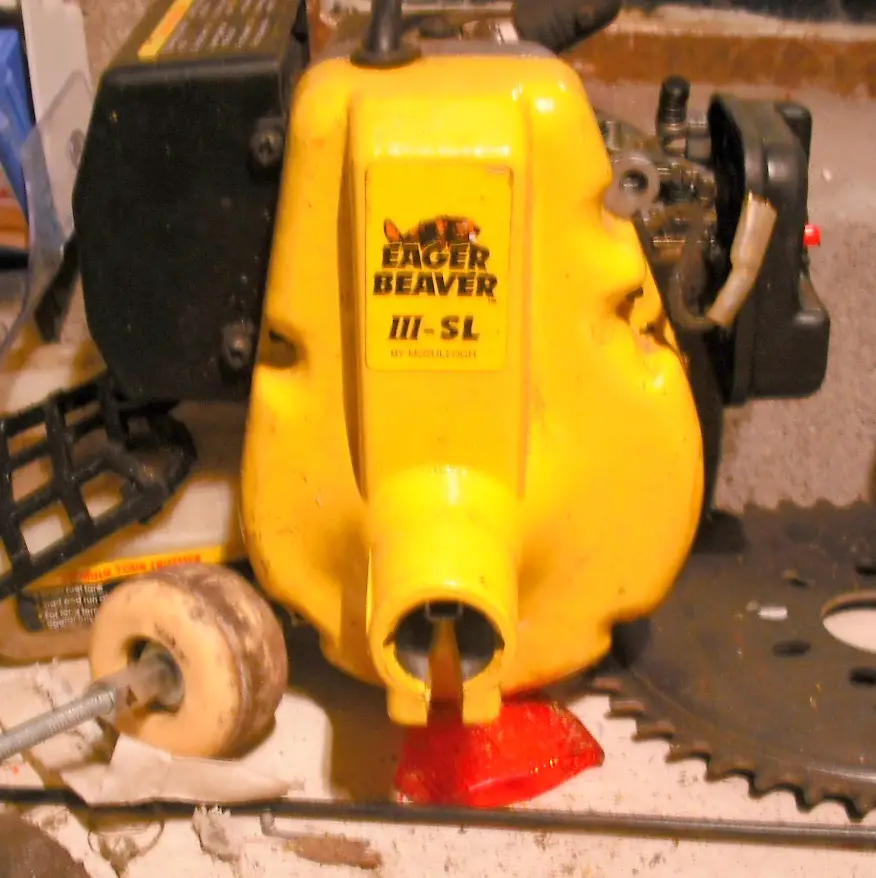

just posted up a good write up on my blog. I got my sprockets in teh mail. I bought them from CS Scooter on eBay. $7 each for a 11 tooth sprocket for a double d shaft... lol
Anyway they came in today and wonderful day that it was it was 60 degrees out (it's December right?) and I got out of work at 2:30pm. Sweet deal.
I get home, shop the case off around the Echo's shaft leaving me with about an inch or an inch and a half to work with. I thoght I might be able to put it in my vise and squash it... Yeah I wish. I'm about 1 foot too short and 50 lbs form being able to do that. A few good whacks with a hammer and I was able to reshape it enough that all I needed to do was grind the corners with my dremel down about a half mm each and I was able to stick the sprocket on. Then slip a 12mm socket over that and pound away to get it set close enough to the case to make me happy. Enough room that a chain will move easily and far enough on to make me happy. Tomorrow I'm going to grind down a 1/4 inch piece of all thread to fit into the shaft and JB weld it in. I'll drill a hole through the shaft and put a cotter pin in it to hld the sprocket on. We'll see how this works.
The pictures show the sprocket, with a 10mm double d hole next to the 9mm sq shaft. Later with it pounded just barely on it. Then on the shaft fully. ANd Finally I included a picture of the Mac Eager Beaver that I have with a Echo like case that will eventually I think get the same treatment.
I made a video but I don't know how to work this )**^&*^ camera. the instructions that came with this heap are like those that with the happy times- just this side of useless and serve more to confuse than to help. Hindrance.
