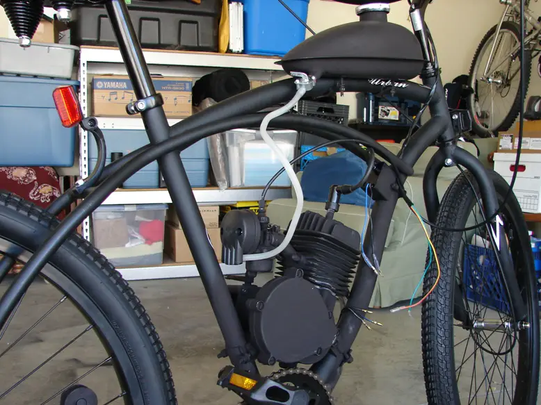

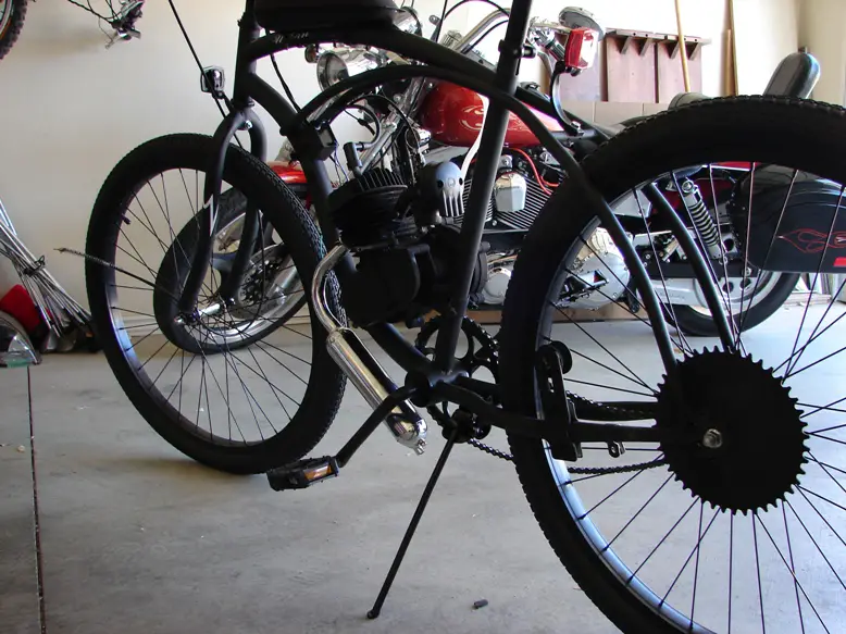

Hey guys! Im a noob and have been lurking here a while. First off, i suck at mechanic stuff. So after about 1 month of fiddling around with my install, I need help now. The instructions as you all know that came with the kit, are horible. I am ready to install the clutch cable. Where do I connect it on the motor? Any one have good close up pics of where it goes and tips to install.
Also, I put my throttle on the right side, screwed it on, then screwed the end of throttle cable to the top of the carb. I tried to twist the throttle, but it does not twist at all. Any help with these last 2 things and I might finaly be riding this thing. please help guys.

Here is a link to a post by Norman, there are some hand drawn pics that show the mounting of the clutch cable, As for the throttle, will it twist if NOT hooked up to the cable? Some are a VERY tight fit over the handlebars and stick.....
http://motorbicycling.com/f4/bicycle...lutch-222.html

Here are some pics of my set-up....
FR31MB/Clutch Arm Pics - Photobucket - Video and Image Hosting

Originally Posted by fairracing31 View Post
Looks like the clutch is hooked up correctly, if you have all the slack out of the cable....You REALLY dont need the second spring ( the one nearest the end ) just makes the pull harder......
Yes. my clutch works just fine....all I need is my pinkie finger to use the clutch.
Sweet! thats what I needed, some good close up pics. I will try to get it set like yours. Do I need to take anything apart from the cable to get it to go through that first piece on the motor? Also, Looking at your pics and the way the clutch arm is set in relation to the chain, what position is the clutch lever on your handle bars set. Thanks again!
